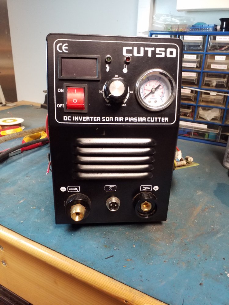

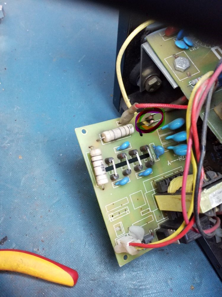

Hi all,
My latest project is trying to fix a Cut 50 plasma cutter that I picked up for a few quid. This is my first attempt at fixing a plasma cutter!
It powers on and when I pull the trigger, air flows and I can measure an open circuit voltage of approx 240vdc. I've replaced all the torch consumables, but it won't initiate an arc when I drag it over a bit of clean scrap.

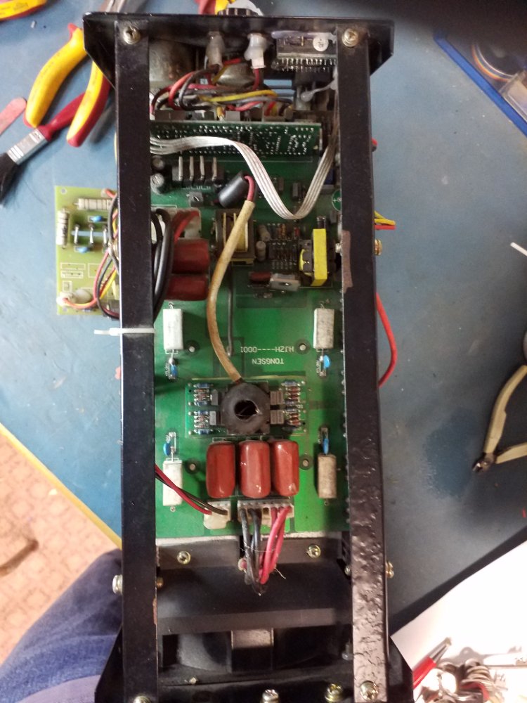

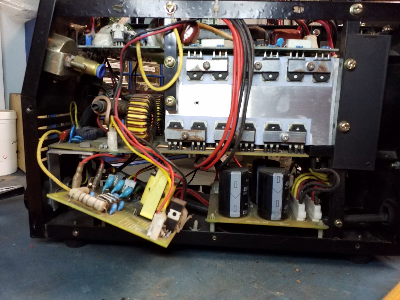

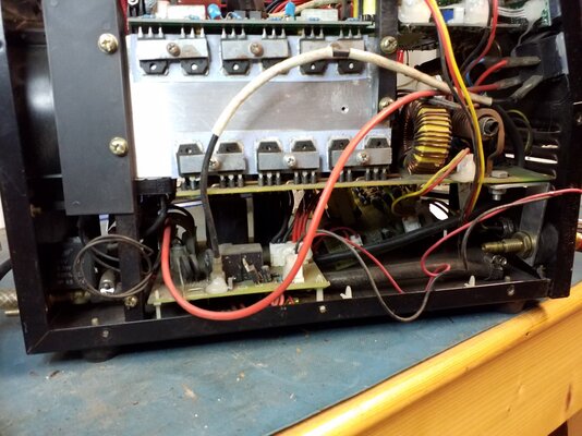

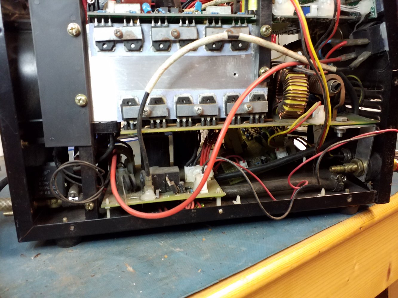

I've took it apart and checked the mosfets, and their gate resistors on the top pcb, plus the diodes on the small motherboard. I've also checked the diodes on the middle pcb, which all appear to be okay.

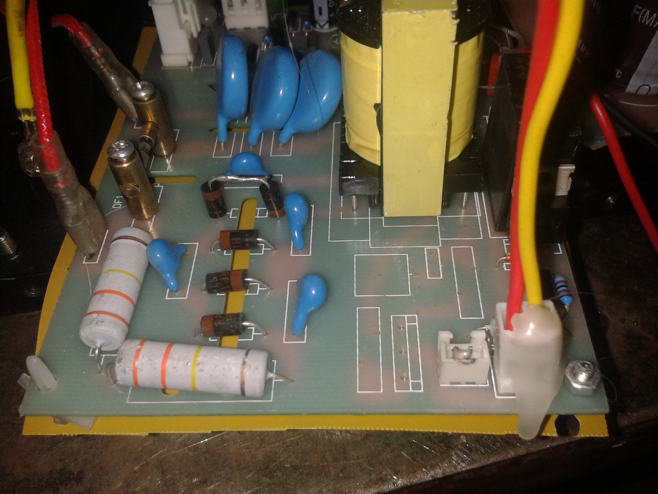

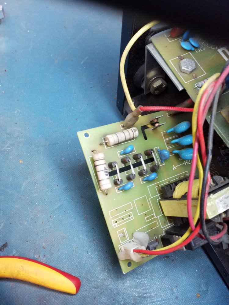

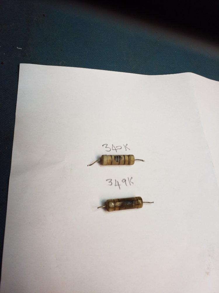

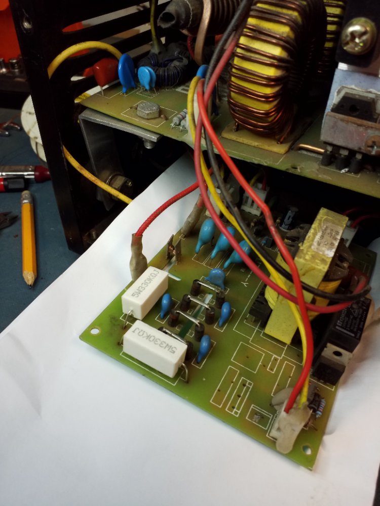

On one of the bottom boards there are two wirewound resistors, which have got very hot and discoloured, so I can't tell what value they should be. They read 340K so I'm assuming they are 330K ? The associated diodes and hv capacitors read ok, but I don't get an arc across the spark gap.
What else should I be checking? Any suggestions will be gratefully received.
Steve
