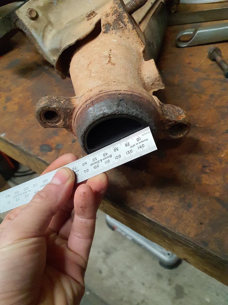

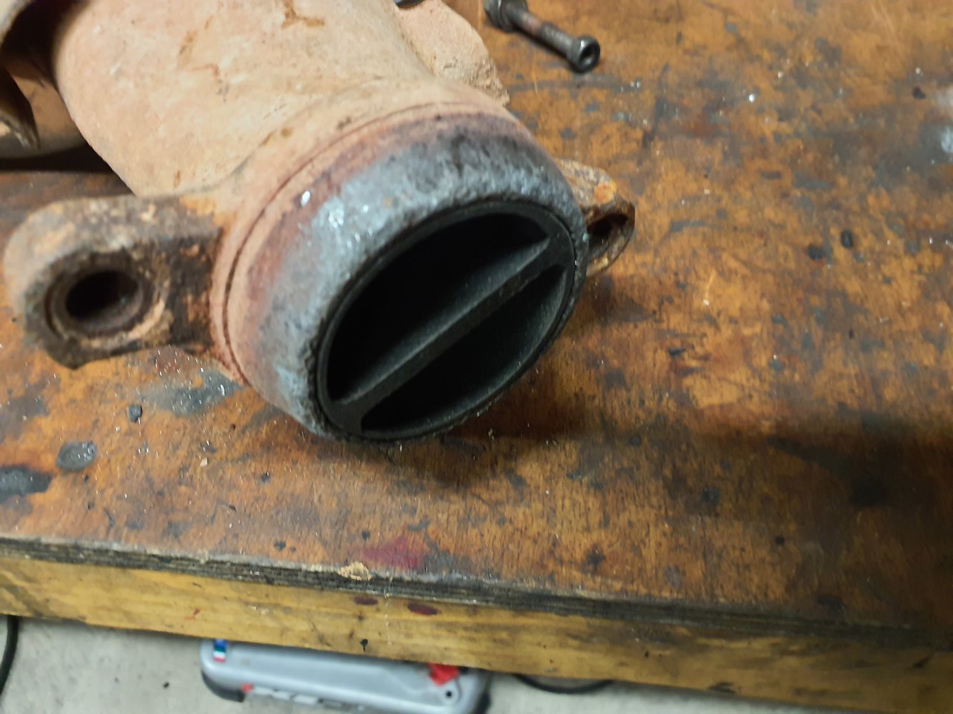

I'm starting to do some Googling and thinking about the exhaust on my buggy build. The photos show the exhaust headers. Do I just use a flared exhaust tube to connect to them? I've also seen "exhaust ball joints" mentioned online, but I'm not sure if that's the same thing.
I've also heard that a stock ECU won't handle an exhaust with different back pressure. Is this true? The donor car had a cat and silencer, for the buggy I was thinking of excluding the cat and using a straight through silencer.

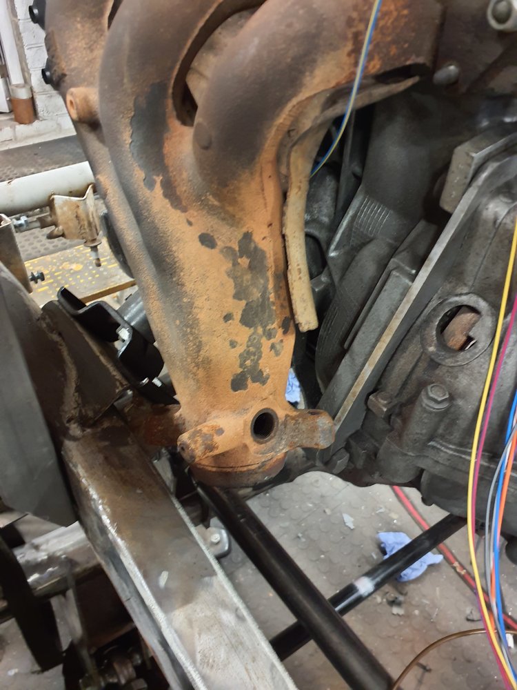

The header is very close to the chassis as the original engine was a 1.3 and this is a 1.6. I'm going to try making a fancy joint to clear the chassis and avoid having to modify the headers or notch the chassis.
Engine is a 1998 Vitara 1.6 injected.
