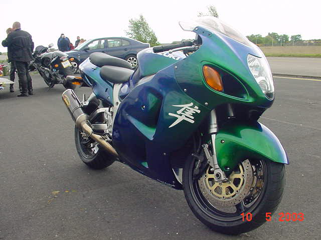

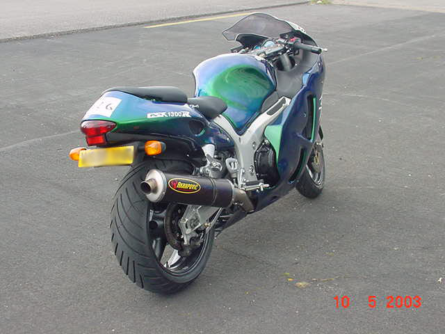

There's a car seen around my way occasionally with an amazing paint finish, looks silver from some directions, or pink, or blue, or a continually changing mix, very impressive, all on a nondescript little hatchback. I have no idea what colour it would have on the V5.As has been said, you'll be wanting a suitable pearlescent flake.
A decent custom paint supplier should be able to create it, but you might need to find a supplier who's happy to do custom mixes, as most will just mix according to predefined mixes/codes.

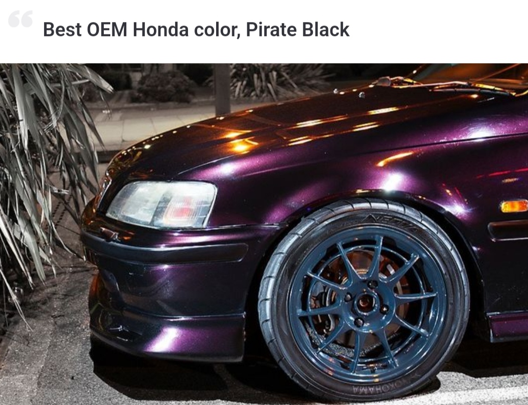

Artificial light will show up more of the base colour, which is why those two pictures look like two totally different paints.has a look at the honda colour and it has potential View attachment 378373
but the internet also shows this a the same colour
which is way too purple??

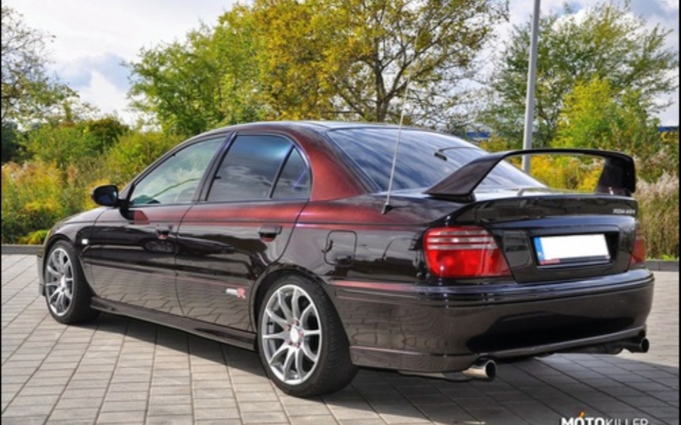

Take a case of guiness, pour a few out and ask them to match itall will mix "custom" colour from a code or a sample.
all ready tried that they could not get a reading.Take a case of guiness, pour a few out and ask them to match it![]()
Nick this was my first thought put down a decent black base and add a tinted clear similar to how Candy's are done?If i had to replicate Guinness, I would probably lay down Mercedes Obsidian then put a light tint in the clear.
Nick
You could also add something for your drop coat before clear.Nick this was my first thought put down a decent black base and add a tinted clear similar to how Candy's are done?
