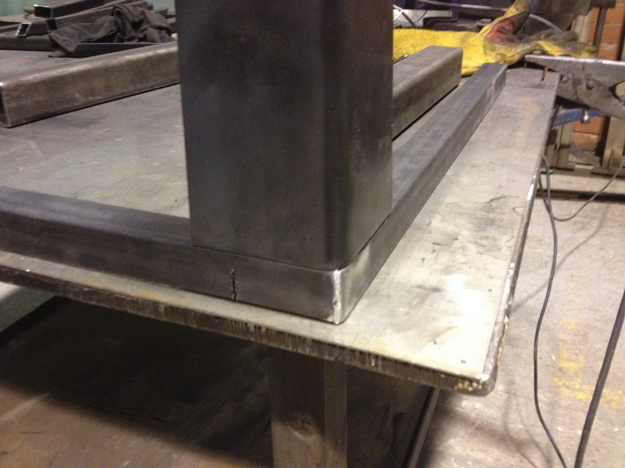

GrahamHggins Member Messages 116 Location London, Barnet. Dec 8, 2016 #1 Hi, what's best way to go about this. I have a curved folded leg and want to join it to an angle section.. my issue is the angle corners are sharp and I want to round it off too. image.jpeg 426.4 KB · Views: 68
Jim Davey R H Davey Welding Supplies Ltd Messages 5,653 Location Southampton Dec 8, 2016 #2 You could notch the bottom of the box so that its outside corner goes right down to the bottom.
pedrobedro Man at Matalan Messages 13,095 Location CX near Chesterfield Dec 8, 2016 #3 Just run the grinder over it.

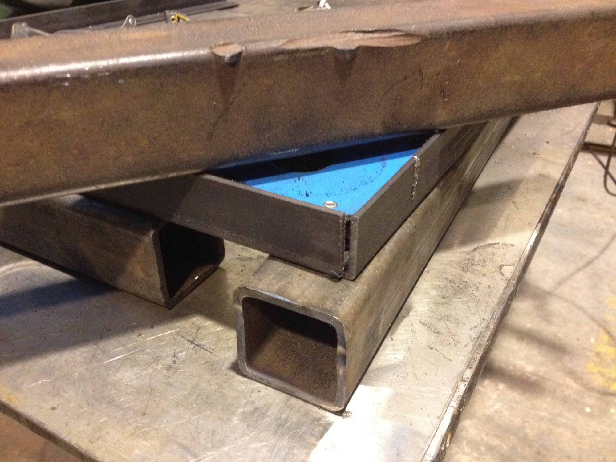

GrahamHggins Member Messages 116 Location London, Barnet. Dec 8, 2016 #5 It was just 3mm so couldn't just grind down. But notching may give me enough to play with on edges... image.jpeg 481 KB · Views: 64

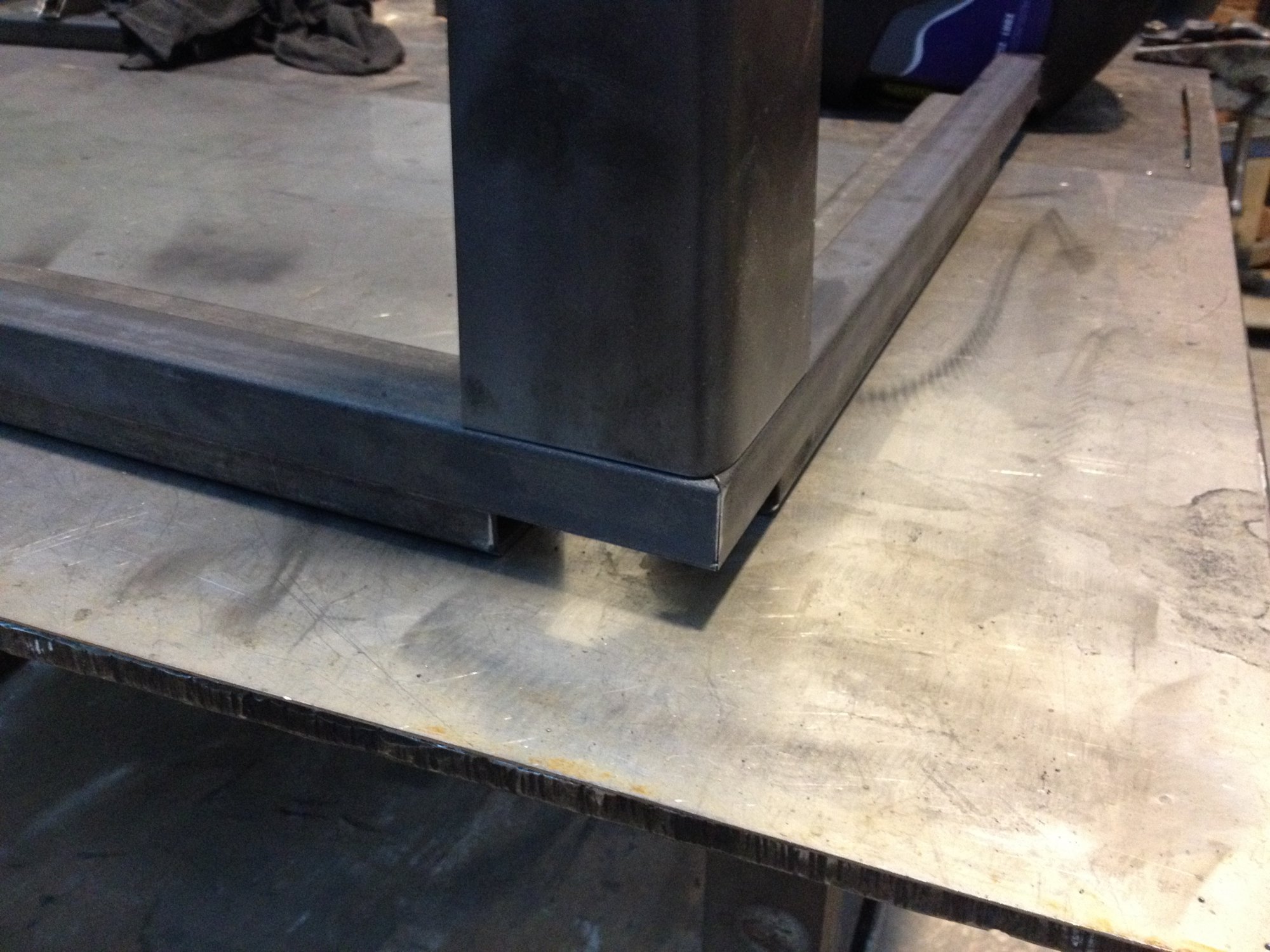

GrahamHggins Member Messages 116 Location London, Barnet. Dec 8, 2016 #6 Filled that. image.jpeg 442.6 KB · Views: 73
outofthefire Member Messages 2,866 Dec 8, 2016 #7 Build up some weld on the inside of your mitre then grind it to the same profile as your leg.
