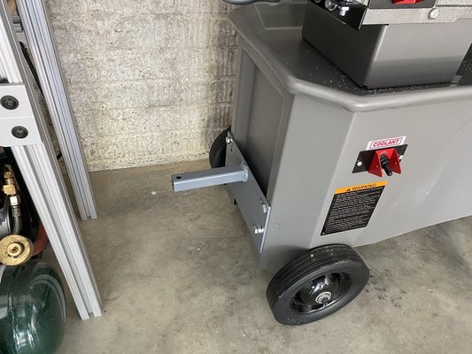

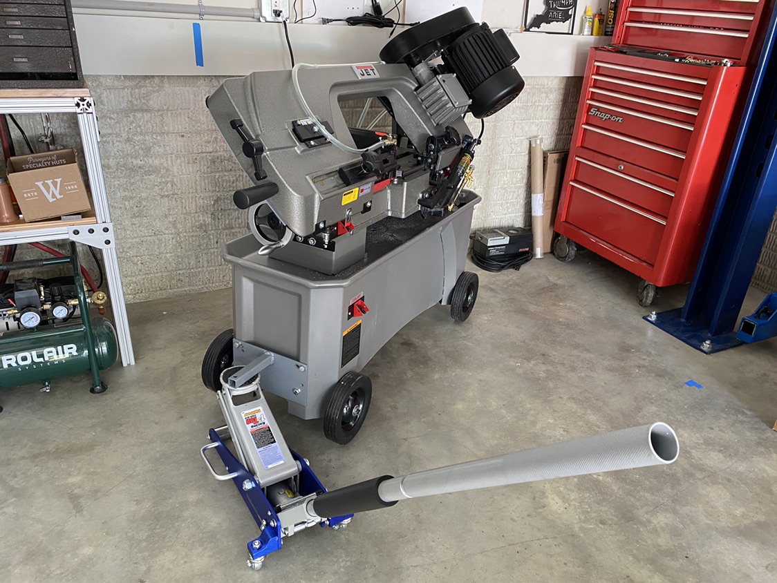

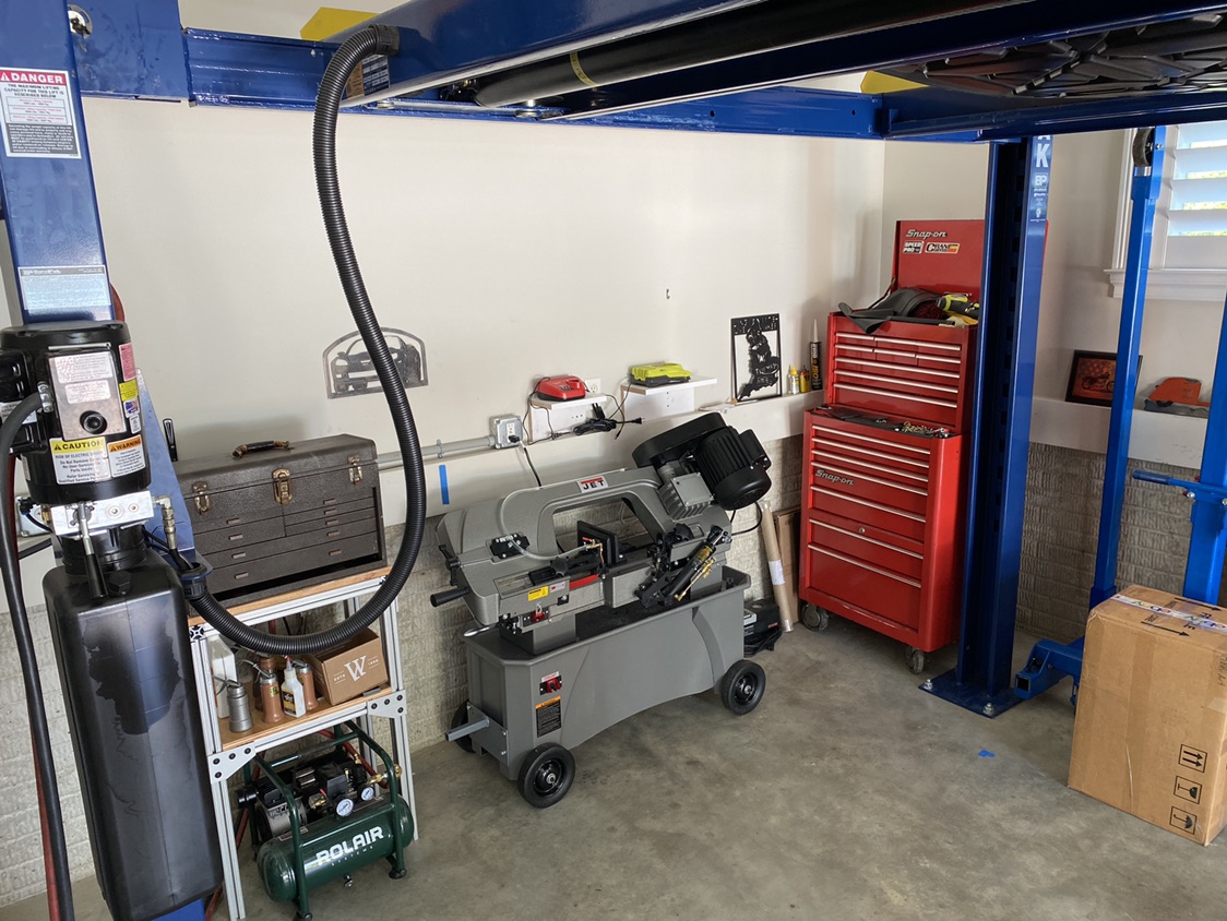

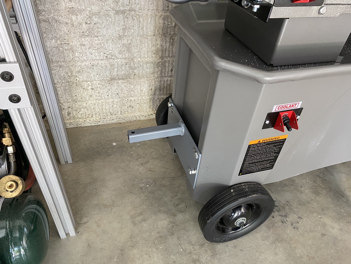

My Jet 7" x 12" horizontal bandsaw has non-pivoting wheels. That makes them useless, since I will need to turn it out from the wall to make room for the stock being cut.
I fabricated a plate with a short length of 1" x 1" square tubing extending out from it. Now I can easily swing the end of the Jet saw out from the wall with a small floor jack.
