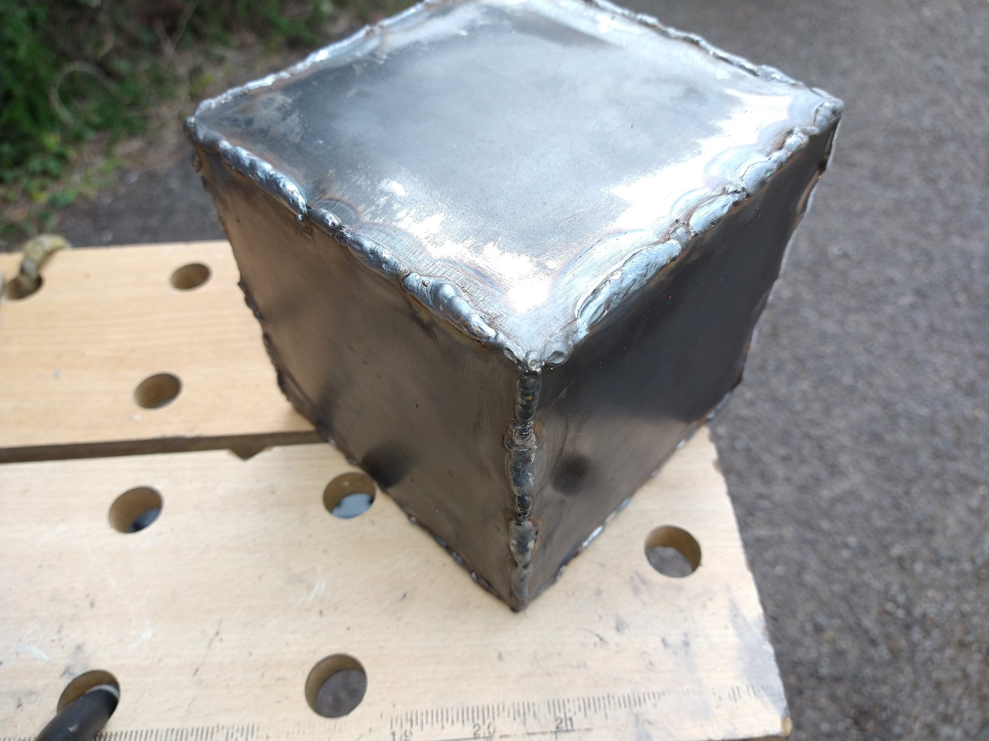

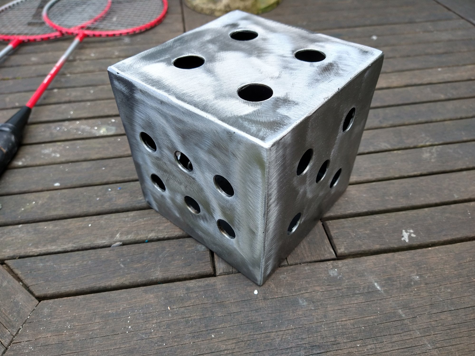

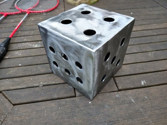

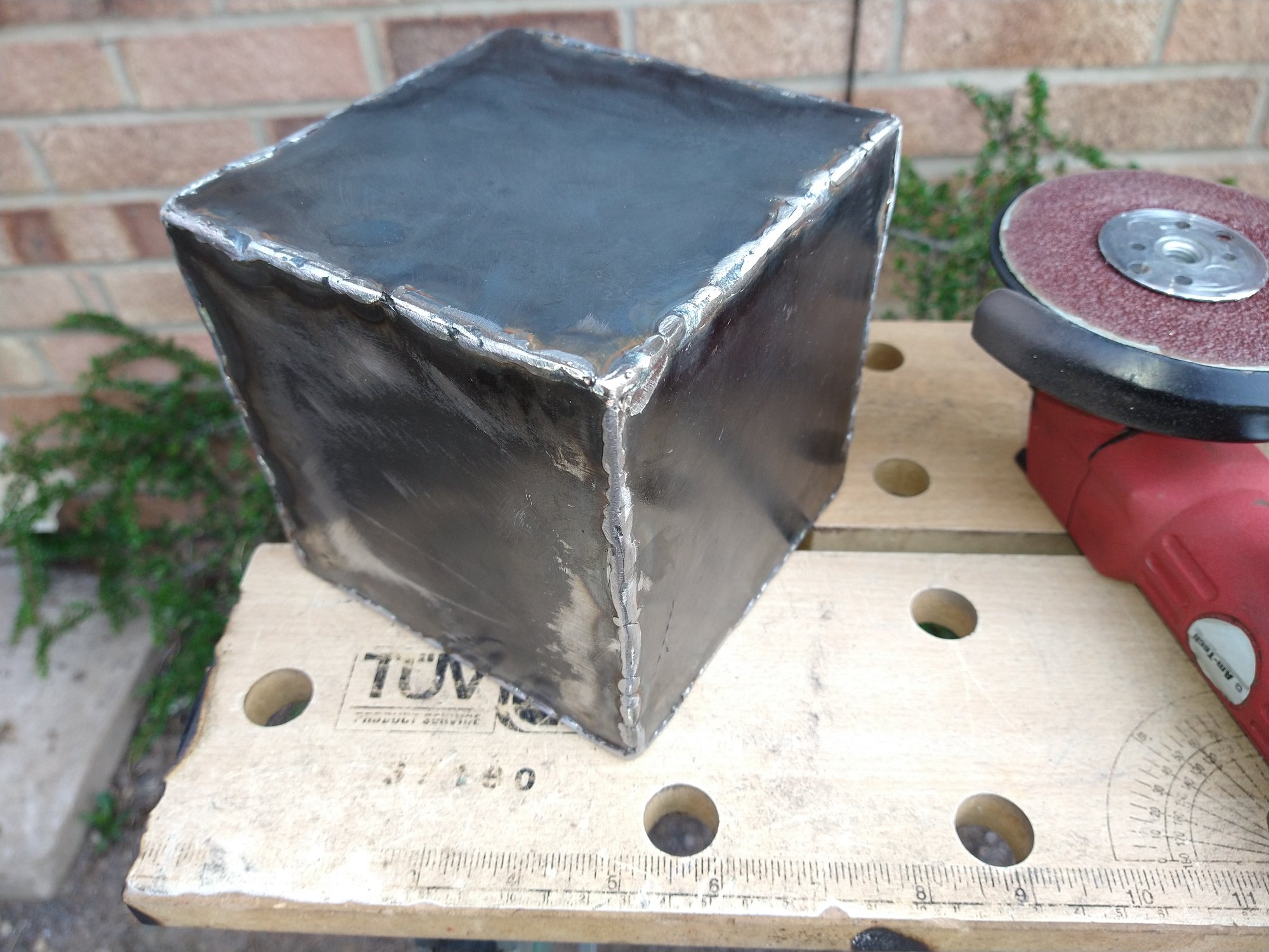

I finished my cube training piece today (I have the Christena book). SIP 105 with .6mm wire and CO2.
I used the Lidl plasma cutter to cut some 2mm sheet, squared them up and cleaned up the scale from the edges.
The later welds were a lot better and removing the shipping plastic film off the inside of my auto darkening helmet helped...
Throwing it up about 4m and getting it to bounce off the road didn't pop any welds. I used a hole come cutter to cut some die holes having first done the maths to avoid it being a loaded die.
I need to work on my marking out as well as my welding. Any feedback is appreciated
