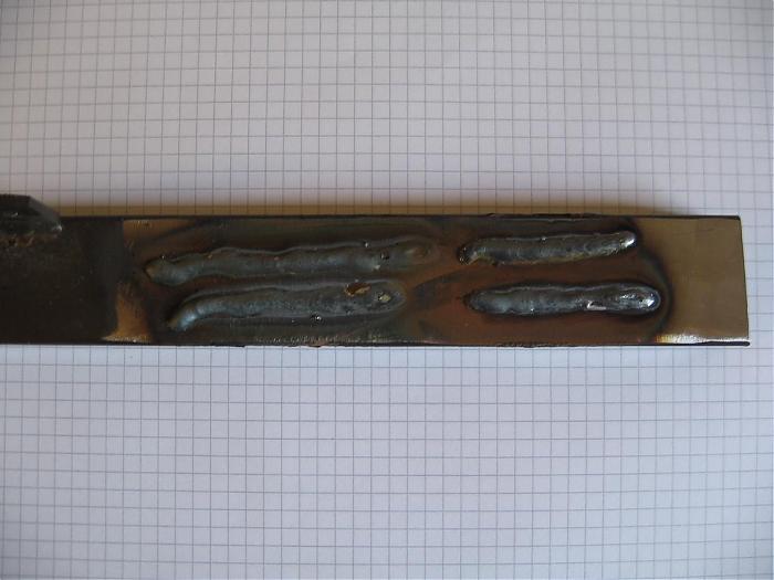

Here's a picture of some test welds with my new gear:
Clarke 135TE
0.6mm wire
Universal Argon
This picture is a test using 1.8mm box section.
I tried a couple of feed settings and power settings.
Since it's box I can't take a picture of the penetration.
Though the bottom left weld was too hot and penetrated too far.
I need to do some more scientific weld tests, especially on thin sheet, before I'm happy.

			Clarke 135TE
0.6mm wire
Universal Argon
