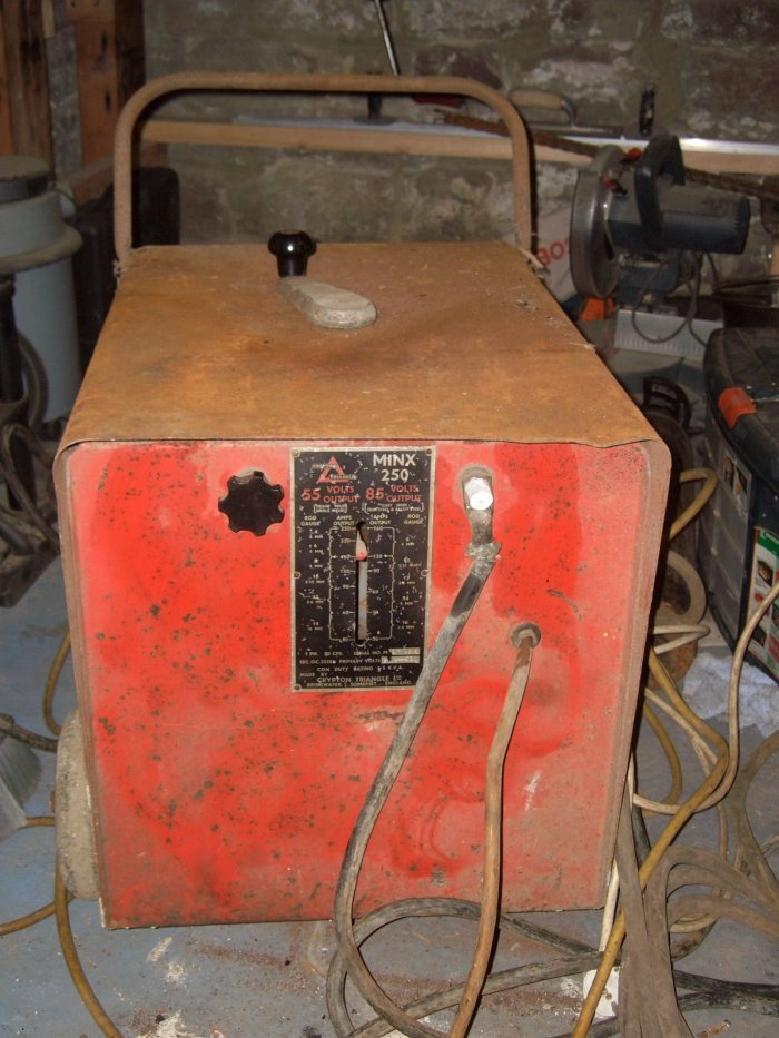

I have a Crypton Triangle arc welder, 250Amp.
Its single phase and seems to be in good working order although it is very old.
Does anyone know where I could get some info on this, i.e. what the settings are.

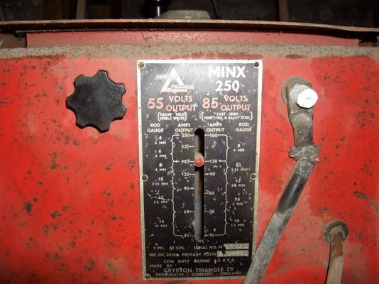

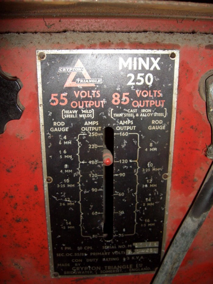

It does have a handle on top, a bit like an window winder! - wasnt sure what it was but your right - it adjusts the amps up or down - there is a scale on the front plate which has cleaned up presst good. In the centre of the scale there is a pointer which muves up and down as you turn the handle...
On the scale plate it says output at 55V or 85V. There are two connectors on the front near the top, one on the left and one on the right. I am guessing that one is 55V and the other is 85V - if so cant tell which is which by looking at it as there are no markings.
It looks like a pretty heavy duty piece of Kit but unsure with it being so old - I am striktly amateur!!
PS - is there an easy way to see if it is oil cooled?
Sorry JSA, sounds like a different machine to my dad's old one. The oil cooled machines I have come across are usually like a square metal tank with all of the controls and terminals on the top. They weigh an absolute ton on account of being filled with oil. I'm guessing yours might be an aircooled transformer from what you say but I don't really know. Just because it is old doesn't mean it won't be a good machine though - I burned a couple of rods with my dad's old transformer a month or so ago and was pleasantly surprised at how well it worked.
It looks an interesting machine. If it works it should be okay on a 13A domestic supply up to around 140 Amp settings, so long as the wiring is good and the welder is not on a long cable. But remember it's marked as drawing 6.5 kva, that's 6500 watts at max input, so you will need a 30A fuse and supply if using it near the top end, welding thicker metal.
Have you tested it yet? Check out the connections and redo them if they look worn or corroded.
So far as oil-cooled goes, check for any kind of top-up inlet around the top of the casing. If it is air-cooled it's a bit unusual, at that age. Is there any sound of a fan when it's switched on?

JSA, I have a similar but smaller arc welder, badged as a "Triangle Minx", rated at 150 Amps. It was made by Triangle Products Ltd., Hyde, Cheshire. I bought it 20 years ago from CG&W Young of Twickenham, it still works fine. It is definitely aircooled - in a red sheet metal cabinet with louvres. It doesn't have a fan.
Like yours, the welding current is adjusted with a cranked handle on top, which moves a metal core inside the transformer. The scale reads from bottom to top, 30A to 150A. The open-circuit voltage is 50V. The two welding leads are hard-wired and exit from the case via grommets, so it does not have a choice of voltage tappings. On your machine, the higher voltage would be used for thin metal or for special electrodes that need a high OCV.
In my naivity I assumed that the 85V setting would have been for heavier gauge than the 55V - shows how much I know.
