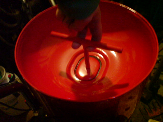

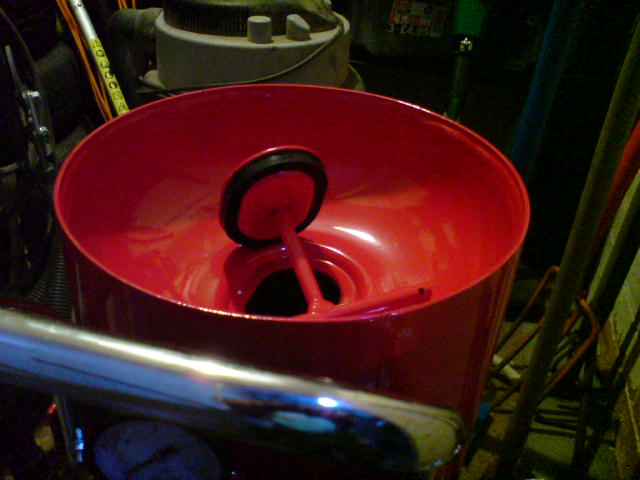

Hi guys,
I've ordered one of these
from here
http://www.martynsbargains.com/matt...ile-grit-blasting-pot-red-sand-blast-pot.html
as these are out of stock
http://www.kmsdirect.co.uk/tools-eq...-sandblaster-auto-parts-cleaning-sandblasting
I've also read on here that I need to get a 3mm carbide nozzle from here
http://www.blastitclean.co.uk/page9.html
so now I need to order some crushed glass. Im already using 60 grit aluminium oxide in my small blasting cabinet, which I think equates to 0.25mm size grit. so am I best off buying 0.2 to 0.5mm grit, or 0.5 to 1.0mm grit for cleaning up rusty car parts?

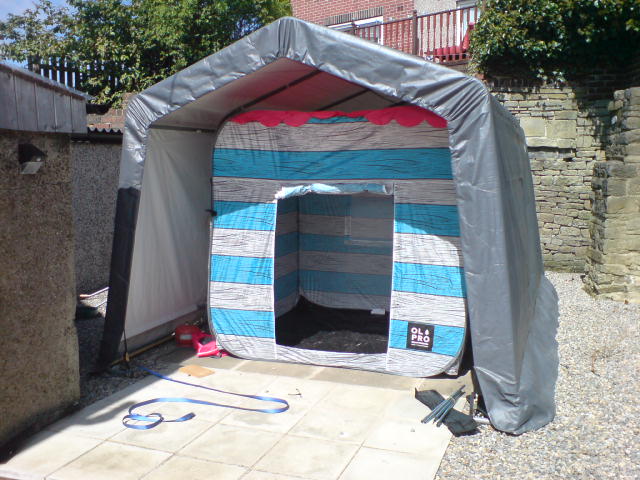

and if anyone else is interested in my other purchases for this, see below :-
Ive already got a pop up beach hut to use a a temporary blast cabinet
https://www.olproshop.com/products/the-beach-hut-blue
shown here in my temporary garage

. So who saved money, wasn't me. Lesson learnt the hard way
as recommended paint instantly
