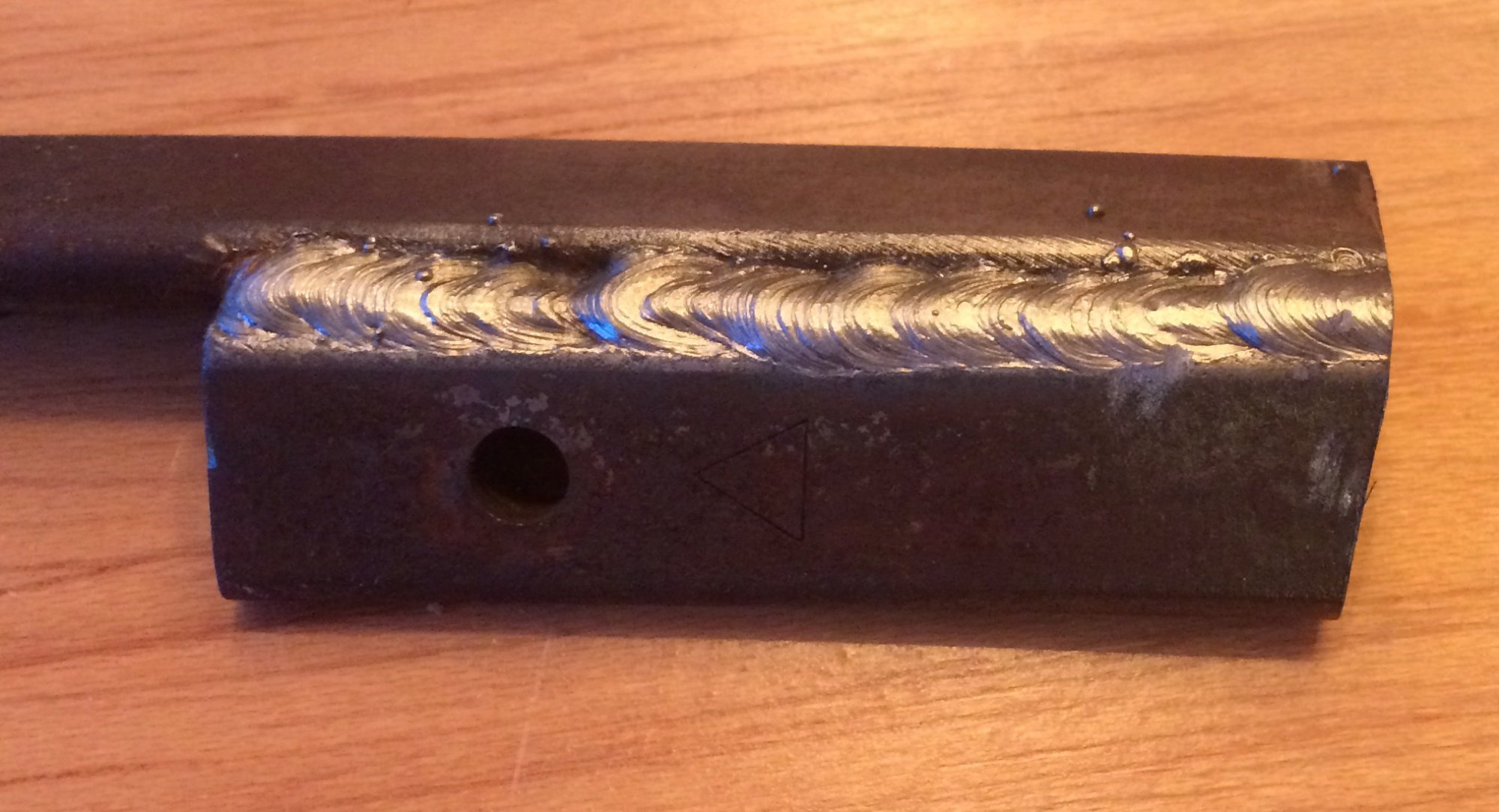

So, onto the pics. I had a broken wood working clamp with a 6mm or so metal bar, decided to run a few lines to check settings then cut a bit off and try jointing it back on
Thought 6mm might be a bit ambitious for such a weedy welder but we'll see what you guys think.

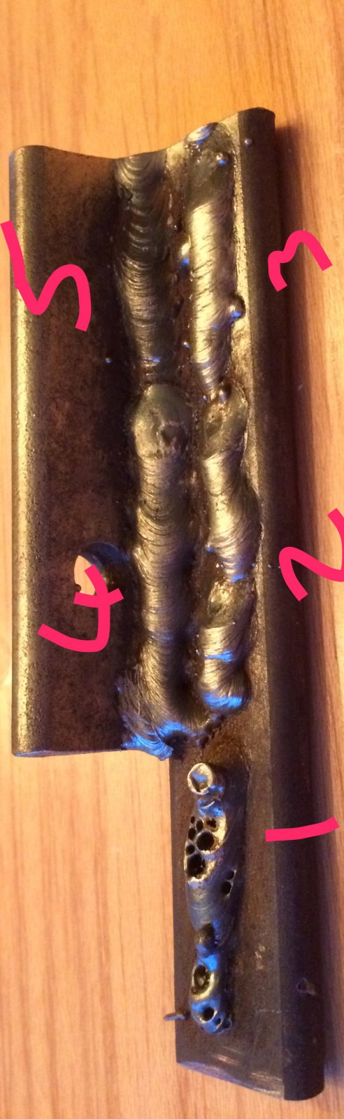

Started off on highest power and wfs of 6:
1) oops, not enough gas (ar co2)
2) wfs too high ? Looked like too much material deposited, sounded too poppy, more like dull bass note explosions
3) wfs of 5, still sounded high
4) wfs of 4, still too much material- travel speed too fast? Didn't make good loops that joined both surfaces to the pool?
5) I think this is better, wfs of 2.5
Did the other side on wfs 2.5 (out of 10) too, think it's around here I need it set and I probably travelled too fast on this one, travelled inconsistently, and didn't stir the pool to the mating sides enough?
If I'm getting the wfs right, how come it is so low when power is on max? stick out was probably 10mm..

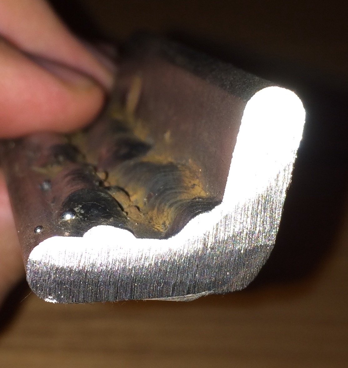

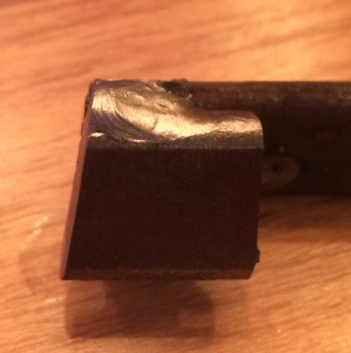

I cut the weld through the section where I thought I'd done the best effort, to have a look inside:
I guess having rounded edges helped the two sides merge..

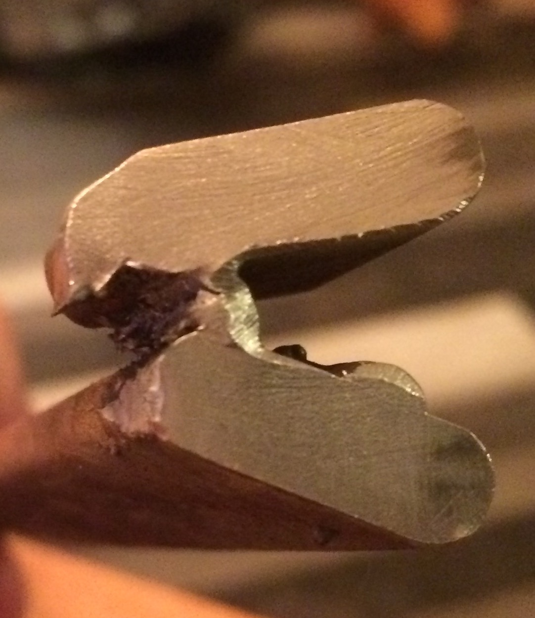

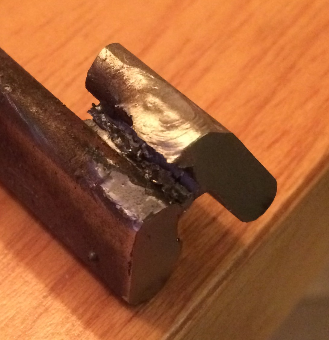

I put the other side on the vice and wound it til it broke, curious to see if the weld had penetrated:
I think it did a little- could that be improved with technique or will this welder never be suited to this thickness of metal?
