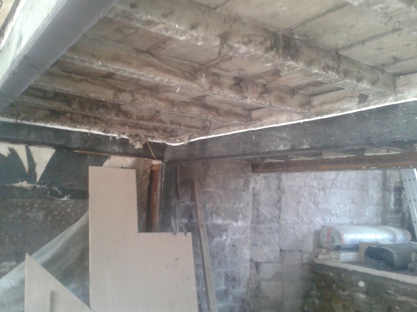

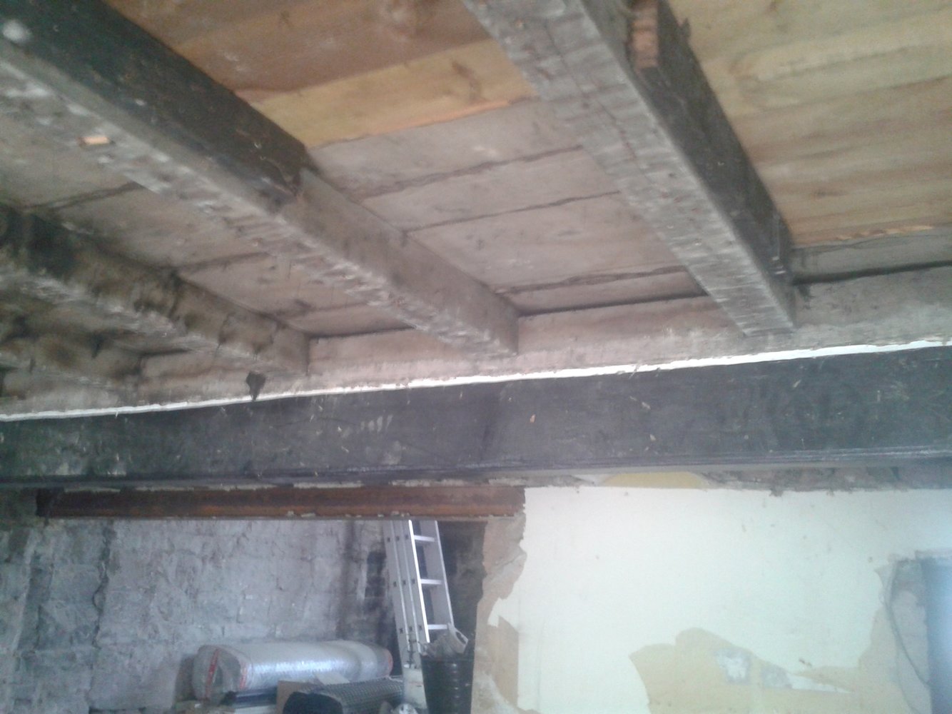

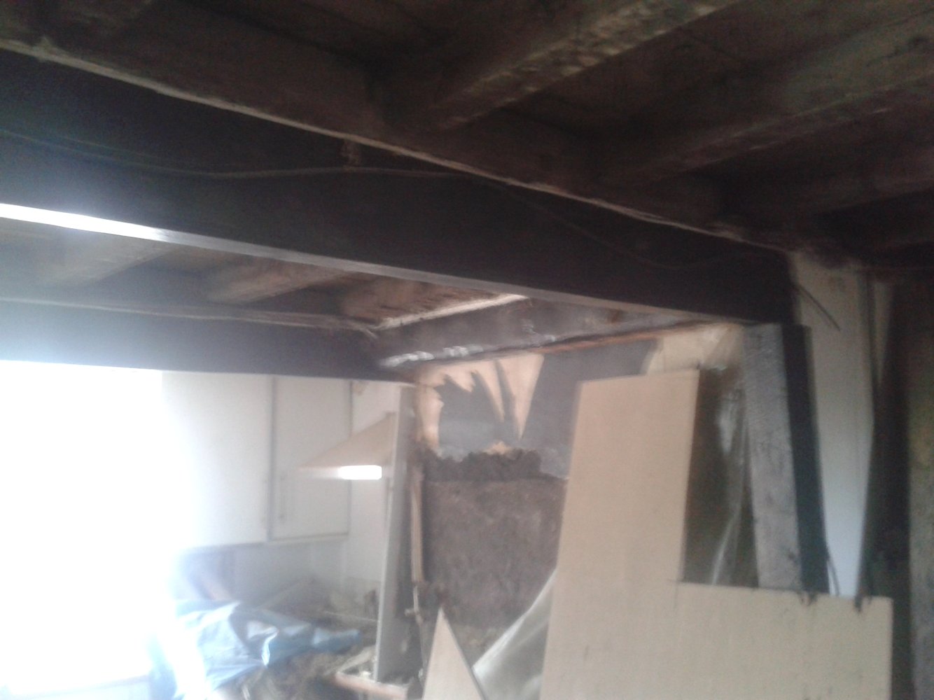

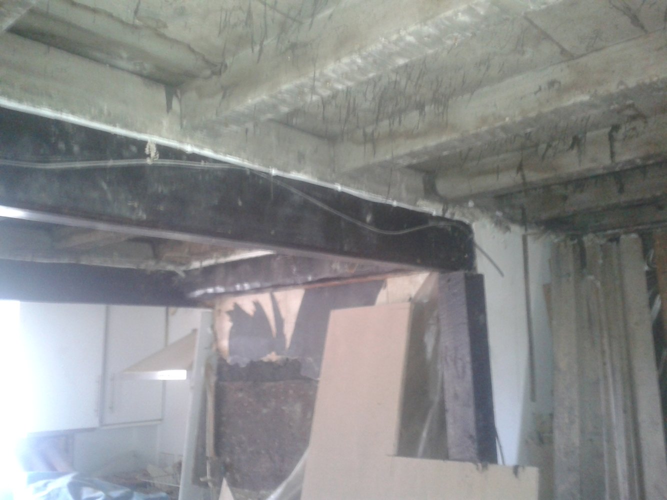

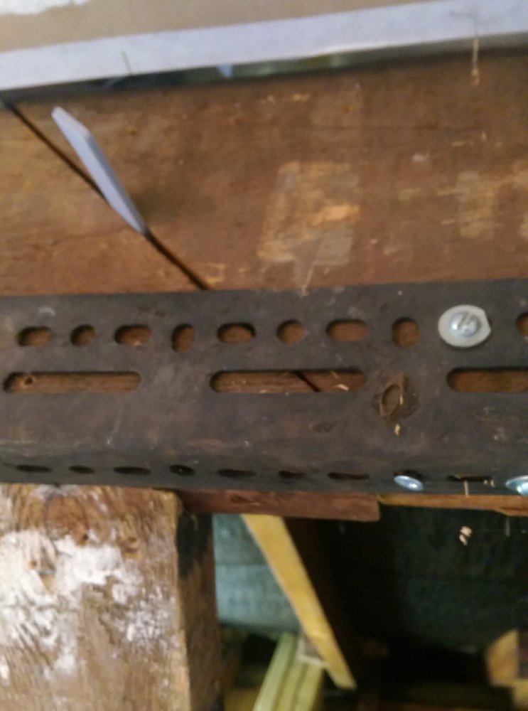

its an elongated spliting crack on the beam as i can see by the pic provided so fitting the filtch steels is going to be difficult
already asked if theres any supporting walls that could be used the op says no so any support is going to be from the ground floor by use of an acrow
