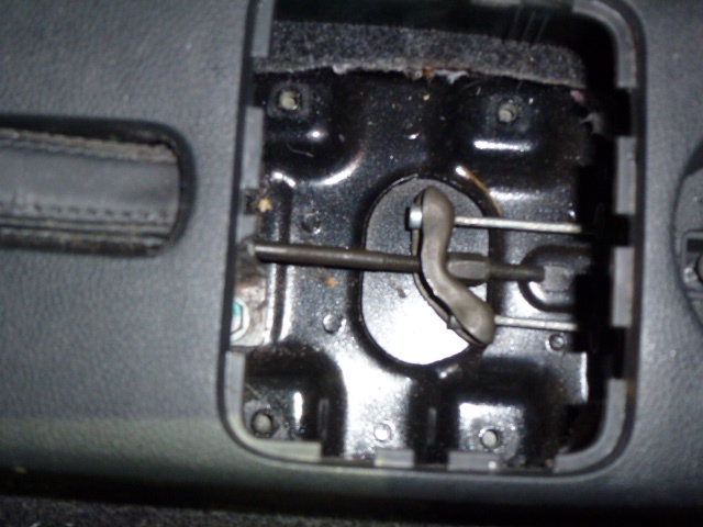

I managed to dig my way to the cables at the handbrake & this is what I found.
No it's not an illusion, 1 cable is nearly an inch longer than the other! With the handbrake down the cables were that loose I could unhook them easily!

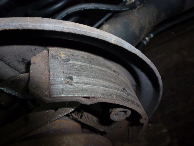

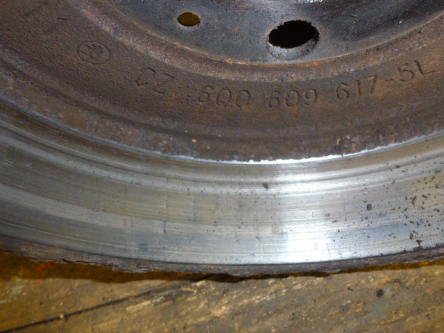

Thinking that the RH cable was broken I removed the drums & found this.
The RH brake shoe worn to the rivets & the drum badly scored, the LH one was ok & the cables were not broken.
What I'm guessing happened is someone either replaced 1 cable or bought a longer one by mistake, bodged it on & tightened the drum adjuster to try to take up some slack. The RH shoes were continually rubbing on the drum & wore down, damaging the drum in the process!
