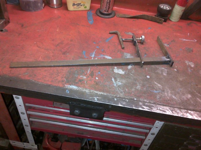

one is a welding clamp that i extended using bit of old box section out of bin at mates whilst doing some repairs to his car.

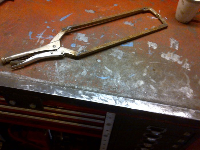

another is a homemade one for a job i was doing foot on it is 2 thick washers welded together with centre hol countersunk so it still as movement.

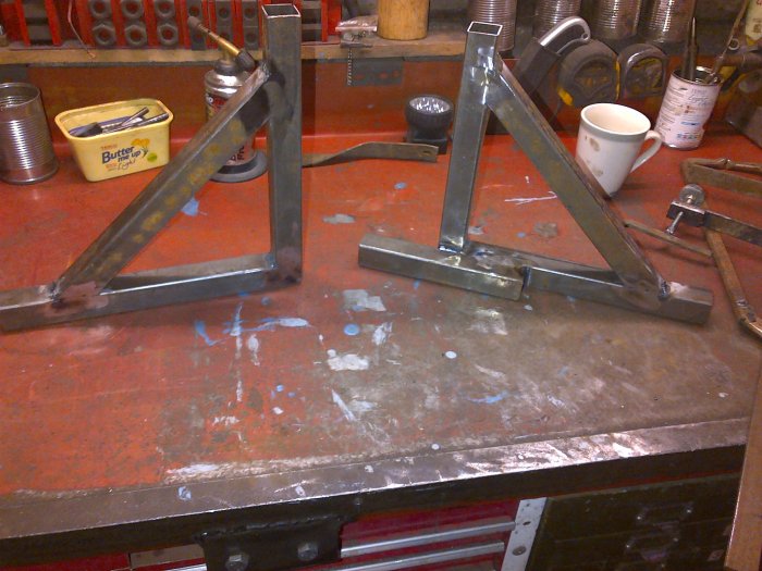

other is two jigs for some frames i was making at time.

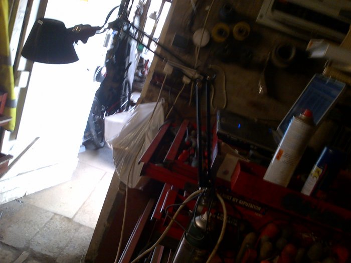

last is just light fitted to side of roll cab to make it easier to see things on bench when welding.
