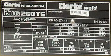

T0rnado69 DIY nut !! Messages 1,894 Location Essex Oct 8, 2018 #1 260amp 3 phase mig with a 4pin red plug. could it be connected to blue plug 32amp 240v and just not used at full wack ?? as the 250amp version is 240v 32amp. but they are like trying to find a needle in an haystack. thoughts. ?

WorkshopChris Member Messages 4,987 Location South East Essex Oct 8, 2018 #2 Probably not, do you have a picture of the data plate or the transformer tappings? A few have one coil basic transformer like the old oxford arc welders, but most will have a 3 phase transformer and rectifier.

T0rnado69 DIY nut !! Messages 1,894 Location Essex Oct 8, 2018 #3 i was hoping but guess it wouldnt be so easy LOL best i can grab from the picture.
WorkshopChris Member Messages 4,987 Location South East Essex Oct 8, 2018 #4 No luck 3 phase only. https://www.clarkeservice.co.uk/manuals2/mig215te_260te.pdf
T0rnado69 DIY nut !! Messages 1,894 Location Essex Oct 8, 2018 #5 just as i thought.. cheers chris il let that one go....... bargain price though.

D dannyp Member Messages 3,168 Oct 14, 2018 #7 Depends on the transformer in it and how it’s all wired up. If it dose 220v 3 ph you’ve got a chance
D dannyp Member Messages 3,168 Oct 14, 2018 #8 Can sometimes butcher it to put all 3 windings in parallel so in effect make one big single phase transformer
