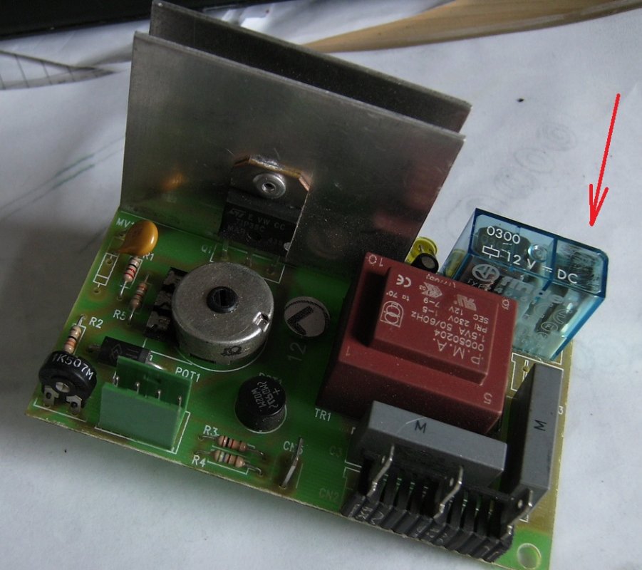

Is my machine salvageable or is it time to go to the scrap yard?
All help and advice appreciated
Richard
thanks for the heads up on the white switches, had that scenario happen way back, so it's one of the first things I check now, thanks for your input.Have a read of this
http://www.mig-welding.co.uk/forum/threads/whats-wrong-with-my-pile-of-junk-now.5368/
and check the white switches
Thanks for the links, also seen them on fleebayRelay is is then,
Forget Maplin their 16A relay is 8A at 230V http://www.maplin.co.uk/p/12v-dc-16a-spdt-interface-relay-n30aw
Farnell have them but Rapid seem cheaper http://www.rapidonline.com/Electronic-Components/Finder-12V-Relay-Miniature-SPDT-16A-DC-60-1015/
Just snip off the extra pair of terminals.
