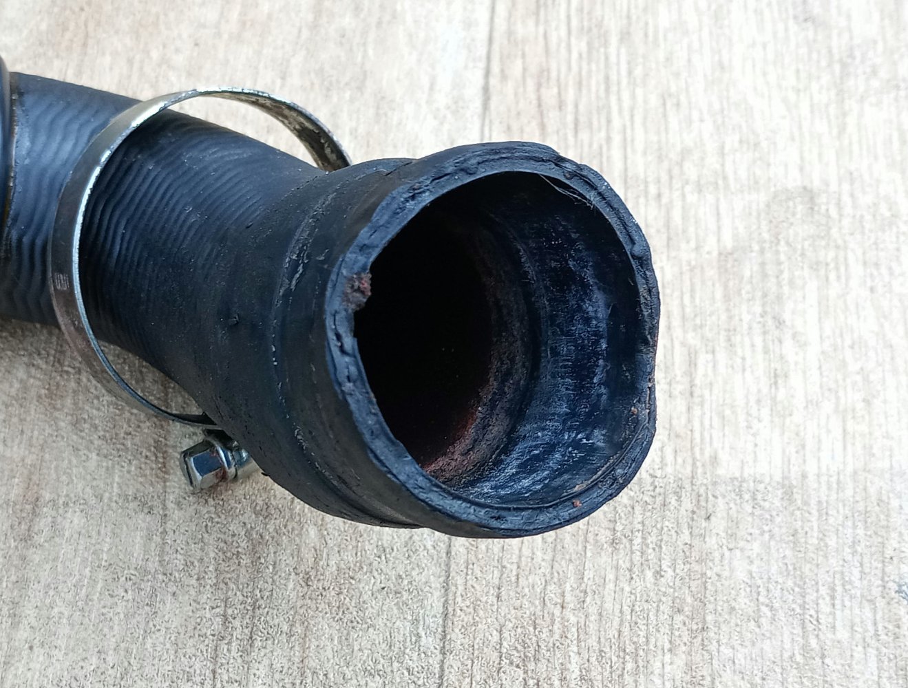

found a hairline crack in the rad, next to the top hose spigot where it had been leaking.
New rad bought and fitted. All looks OK warming up, no leaks
Leak found and fixed

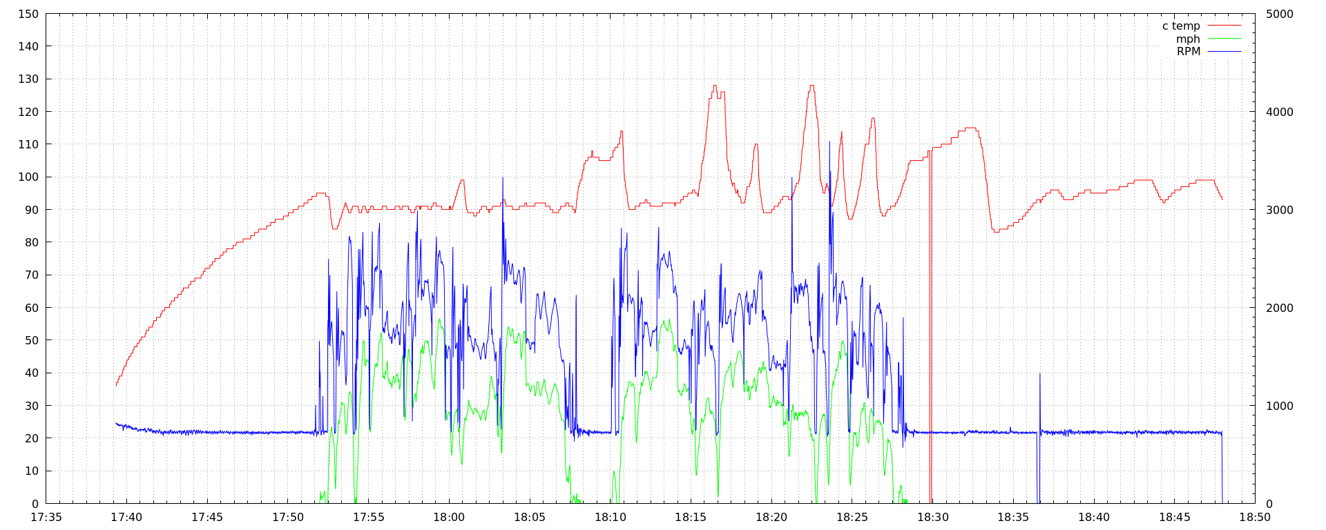

all now seems absolutely normal.

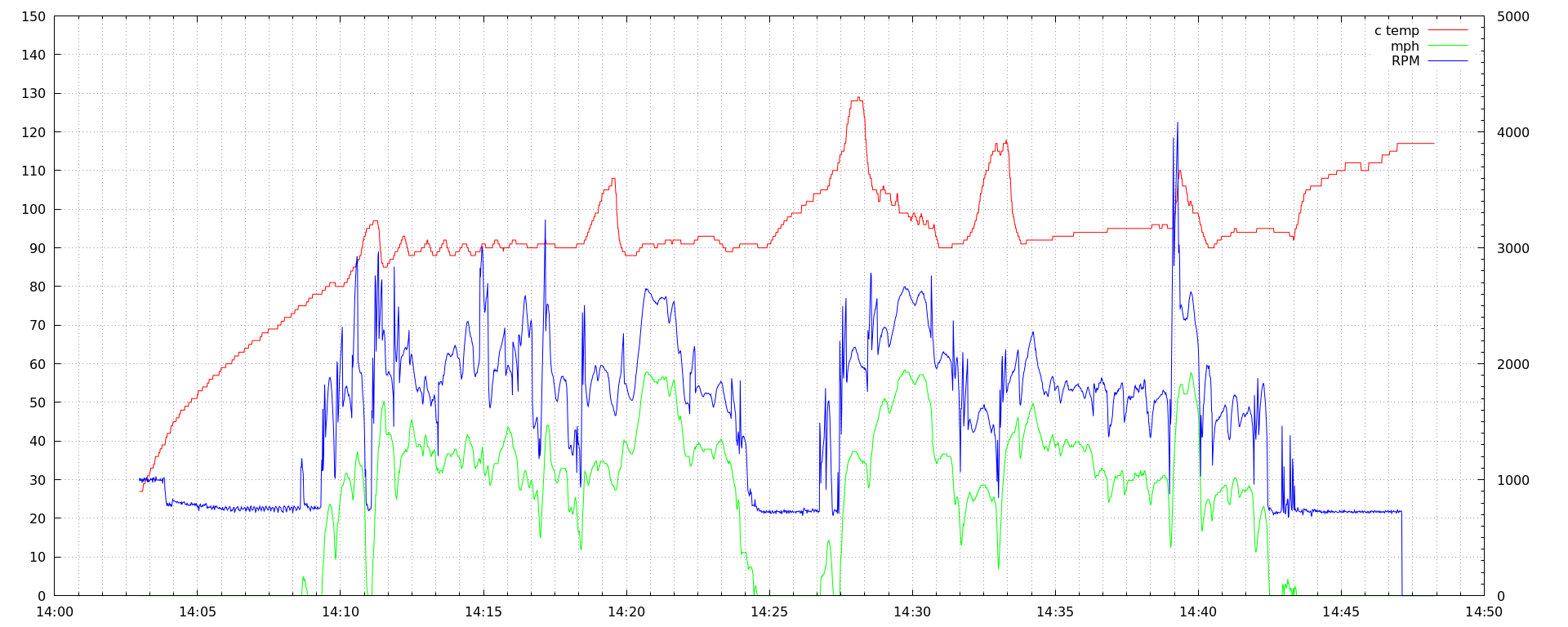

Bad connection on temperature sensor found and fixed?
The only thing I can think of now is something stopping the coolant flow
Other than double checking the condition of the wiring around the temperature sensor, do you still have a problem?
