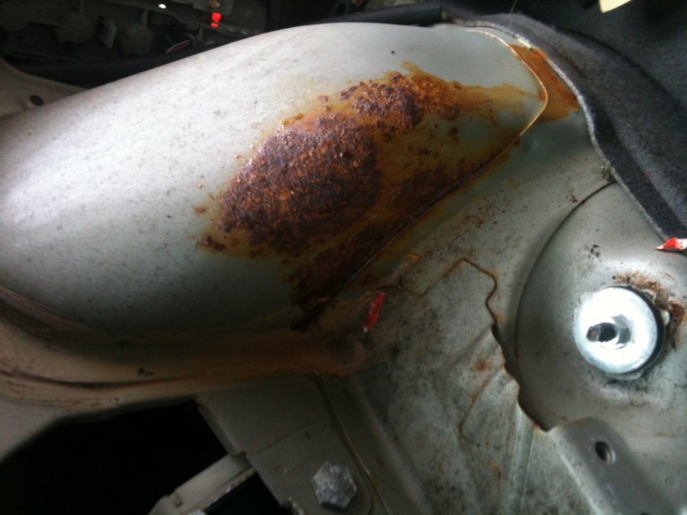

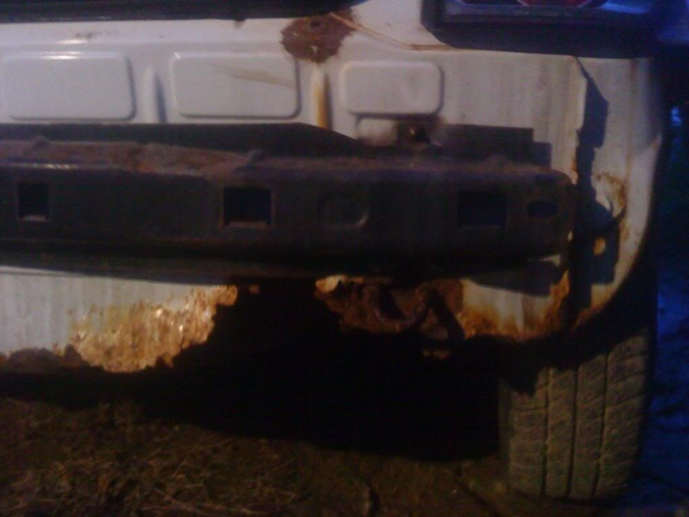

I have a corsa b and I took my rear bumper off to have a look and the panel iS rotten so bought a new panel was just wondering if anyone could give me a quote for cutting out the old one and welding the new one in because the quotes I have been getting is 800+
Is that price from more than one repairer, I must be out of touch because it seems a lot to me, unless it is a 'don't want the job' price or they know from experience there is a lot more behind that will require work.
Probably the last 6-8 inches of the chassis rails are needing patches too,around the towing eye usual corsa rust areas .still ,£800 for that is a huge joke lol.with the rear panel supplied by you and box the ends of the chassis rails done would look more like £250 tops.
don't you weld ?, they are a very simple repair, just get a spot weld drill bit remove spot welds and plug weld the new one in place
if it anything like a vectra b it will have leaks in the boot, the Vectra's leaked where the roof joined the rear panels and water ran down the inner soaking the boot floor at the sides also rear windows and especially the boot seal which is evident in your picture from the rust where the seal fits
