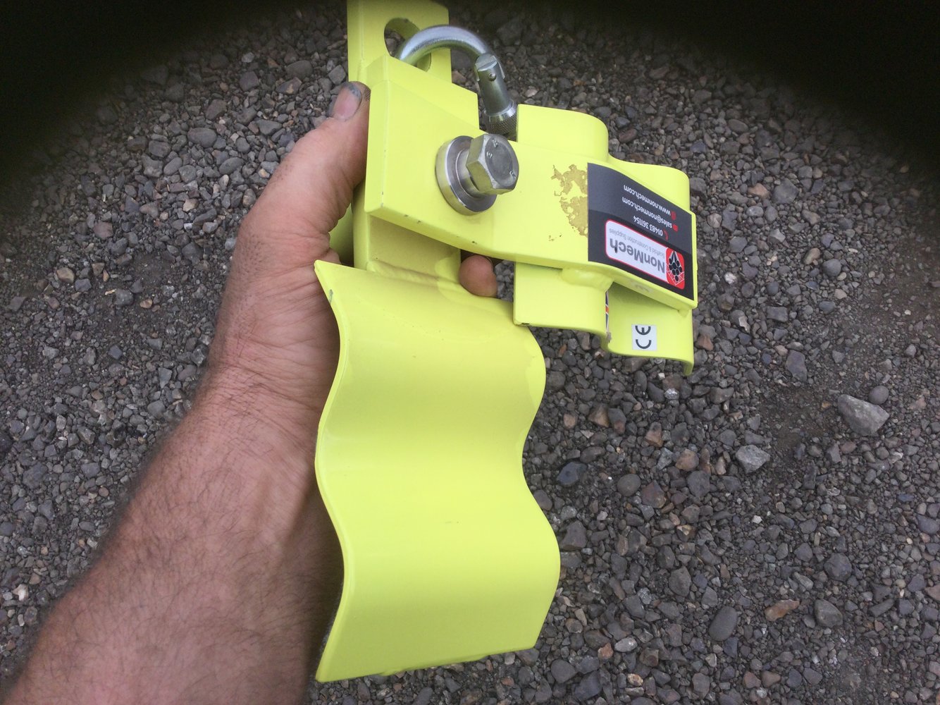

Quick one for the crowd: we've got a job on which involves a bunch of guys dangling on ropes while they inspect the wall of a 20m tall storage tank. The tank is lagged and clad in corrugated sheeting, which needs to be removed to gain access. Not sure what the sheet material is or exact size, but the thing that's got us scratching our heads is how we hold the sheets while they are lowered (safely!) to the floor. There's no scope for powered access (or we wouldn't be using rope access techies).
We envisage a pulley system fixed to the tank top, with ground-level operators lowering the sheets off once they're freed.
Plate lifters won't work since they'd have no clamping force until the load comes on; anything that involves clamping jaws would need some pretty big jaws, but how would they work on corrugations; and although we could punch holes and bolt lifting lugs on to the top edge before each sheet is detached, it would be extremely time consuming and cumbersome.
Anyone got any experience we could tap into?
