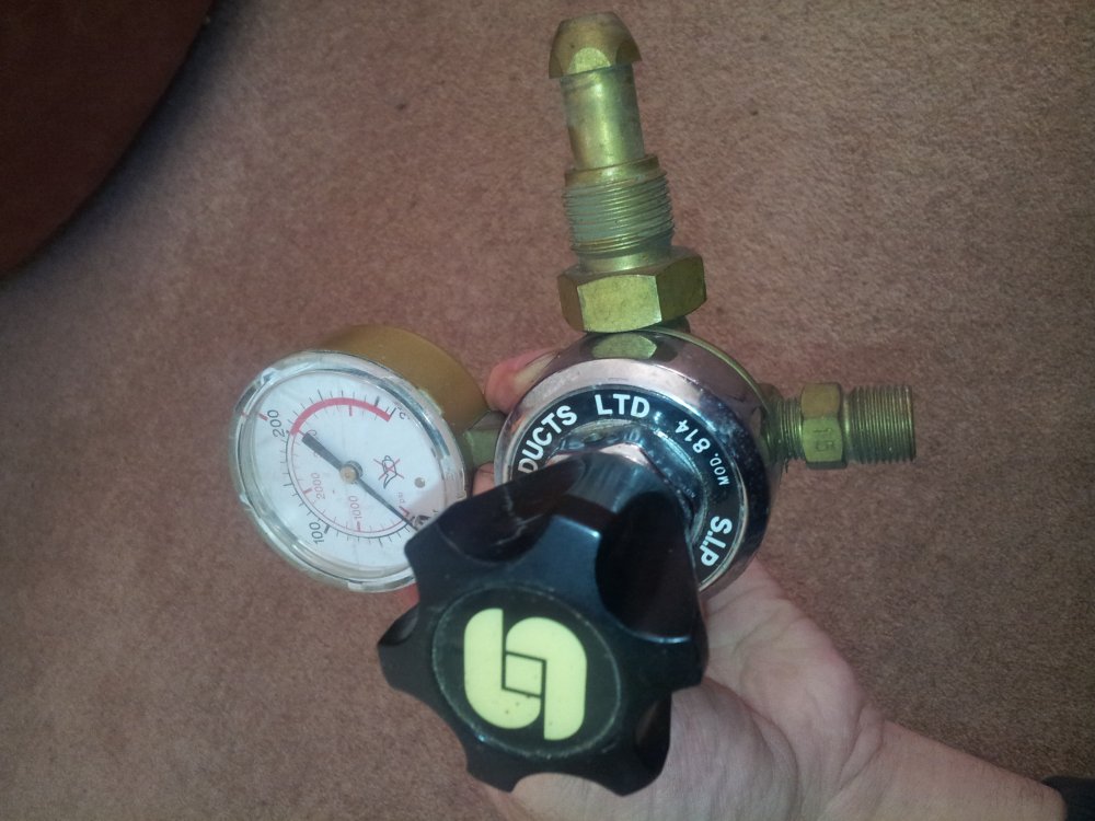

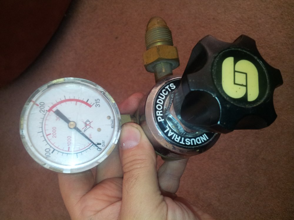

txargyll Member Messages 101 Location Scotland, Argyll Oct 4, 2014 #1 hi, i have this gauge as part of a deal i got on a Ferm 130 welder. What kind of tank can it be used with, is it for use with Argon? 20141004_172023.jpg 113.9 KB · Views: 84
pedrobedro Man at Matalan Messages 13,119 Location CX near Chesterfield Oct 4, 2014 #2 That would work with argon, argon mix or oxygen as long as the pressure rating is high enough. Does it say 232 bar or 300 bar anywhere on it ?
txargyll Member Messages 101 Location Scotland, Argyll Oct 4, 2014 #3 Dial goes to 315 bar, nothing on unit says 232 or 300 anywhere else? , if i turn the black knob completely out it says LPM
H hotrodder Member Messages 4,539 Oct 5, 2014 #4 The pics show a red line at 200 bar on the gauge, that's it's max working pressure. While it'll physically fit a BOC cylinder they fill to 230 bar at 15 Celsius
