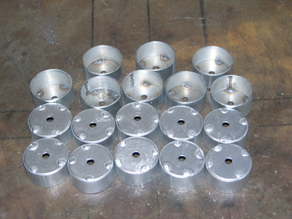

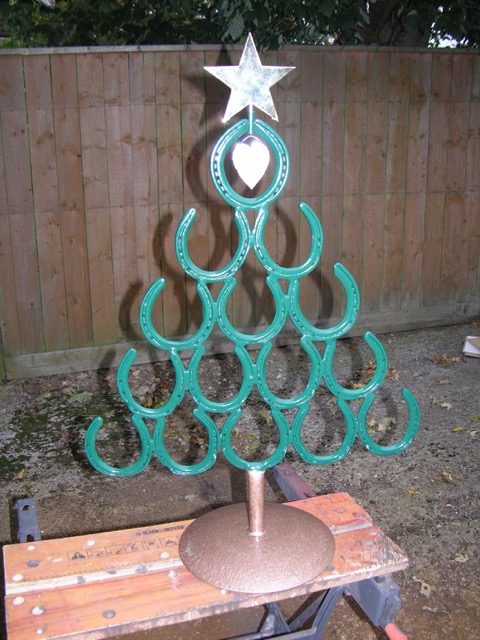

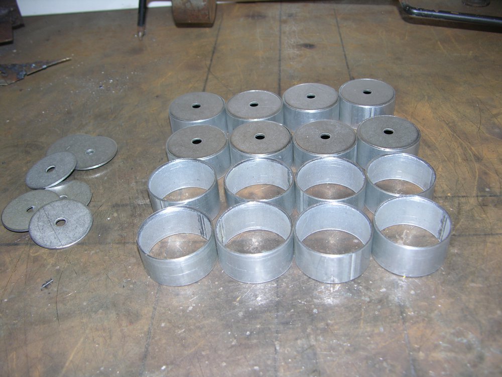

For dished cups use a ring and a ball tool in the press, a towbar ball hitch is a handy press tool.View attachment 75042 As per title folks, I made this christmas tree recently, and as a final addition fancy welding a cup shaped holder to each branch end to hold one of those small battery T lights, I believe the cups would need to be 40mm inside dia, Question is could I press some of these myself from 1mm to 1.5mm sheet steel, and what tool would i need to make. got a shape in my head but don't know clearances and exact shape req'd, I only have a 10 ton press. I'm planning on making another couple of the trees, so would need a few cups. Unless you chaps know where I can buy some fairly cheaply.
It would help, its one of those things where it takes a while to get it to work as you want, without any faults and then if you change material supplier or something moves it all goes to pot. It's fun playing with though!Thanks for the reply Wendlspanswick, The image I had of the die is virtually as you describe, I was thinking small radius on the die top edge, and clearance to suit the "punch" dia, would it also help to have a recess in the die to locate the blank plate centrally?
Getting everything lined up can be a struggle
