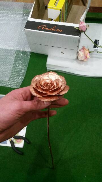

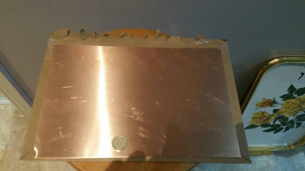

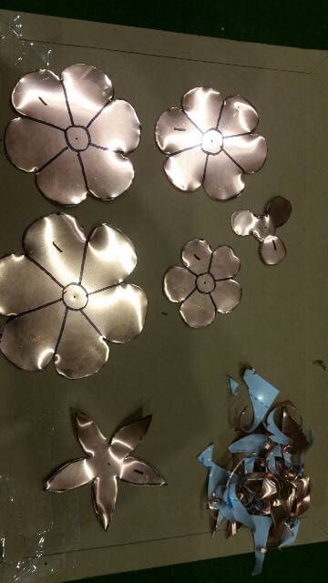

I was asked by a friend to make a copper rose last week. Started with 0.5mm copper sheet:

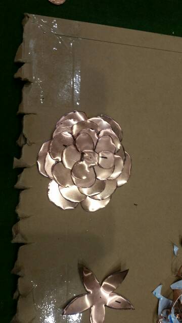

Cut out the petals and leaf:
then bashed with a cross pein hammer to get some texture:

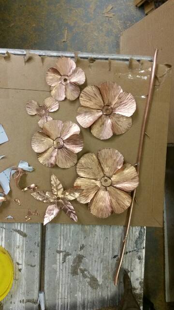

soldered some bits of wire into a length of copper brake pipe to attach the foliage

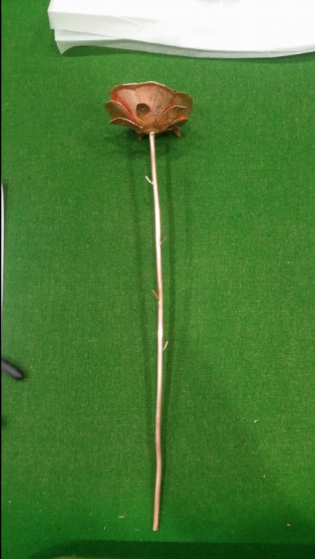

photo of the finished flower:

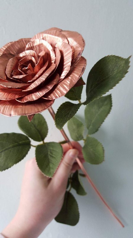

fortunately the recipient sent me a photo when she got it:

Worth removing the felt tip from the leaves next time, when you've finished. Just a little finishing touch.
