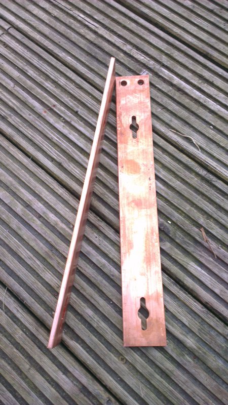

dobbslc Forum Supporter Messages 12,863 Location Hertfordshire UK Aug 13, 2015 #1 I've got a bit of old busbar, can it be used as a heat sink for tig welding thin materials? It's about 5mm thick.

the snooper getting older by the day Messages 21,067 Location Hull UK Aug 13, 2015 #2 yeah a few people are using the same for mig so don't see why not
AndersK Member Messages 1,490 Location Sweden Aug 13, 2015 #3 Almost anything can be used. Best if its metal that dont fuse easily with rhe ones being welded. Stealing an image from Superior Welding here: https://instagram.com/p/5D9xg-jlWJ/

GrahamGKD Forum Supporter Messages 1,437 Aug 13, 2015 #4 I have some copper like that (maybe a bit wider depending on scale) which I use and have had no problems.

sardine Member Messages 3,721 Location Buckinghamshire Aug 13, 2015 #6 I use my assortment of copper bars for filling in big gaps, it gives you something to sit the weld on. You can also grind a groove in it and use it to back up a butt weld from one side.
