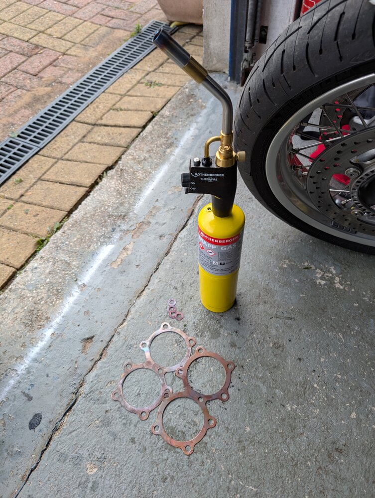

I recently posted on another site for advice on greasing new copper head gaskets ( as recommended in my 1969 Triumph workshop manual) or I had seen folk using spray on Permatex Copper Spray Gasket on them.
I have always just greased new copper gaskets (from a reputable manufacturer).
Quite a few folk said to always anneal a new gasket as they harden, I have never done this, so tried it today, quite a noticeable change in feel, so seems worthwhile - was also advised to add some car shampoo to the water to prevent scaling, seemed to work too - every day is a school day!
I contacted my old friend who worked at Triumph Meriden, he confirmed they never greased the head gaskets in the factory!
