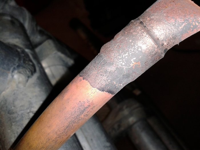

looks like copper phosphrous rods they're good for copper to copper without any flux as the phosphrous acts as a flux, but sifbronze rods can join cast iron,steel brass & copper with flux nice join all the same.
Cheers dude I am sorry about my lack of knolage in brazing I just asked one of the ac engineers if I could have a go as it looks fun for a first attempt im happy
