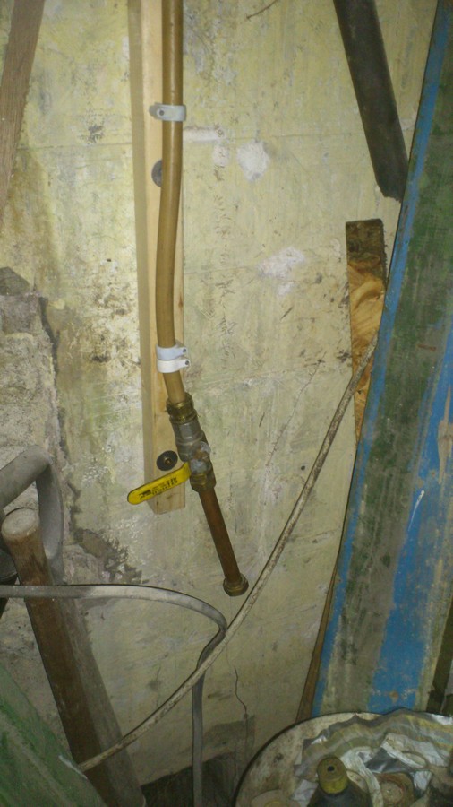

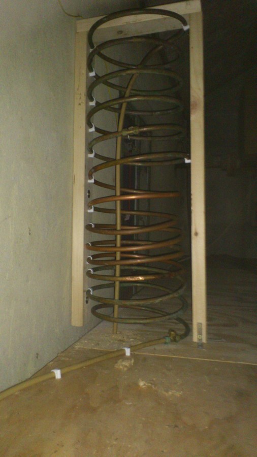

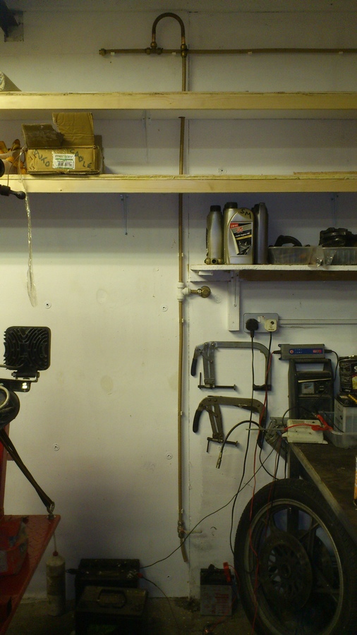

The Cooler... 36ft of 1/2" copper recycled from heating coils. Turned out better than I'd hoped for, as it was a right bodgy job, as the coils had been outside for years and had frozen and split in a couple of places. A few repairs and a bit of jiggery-pokery, and it holds air well. So far.

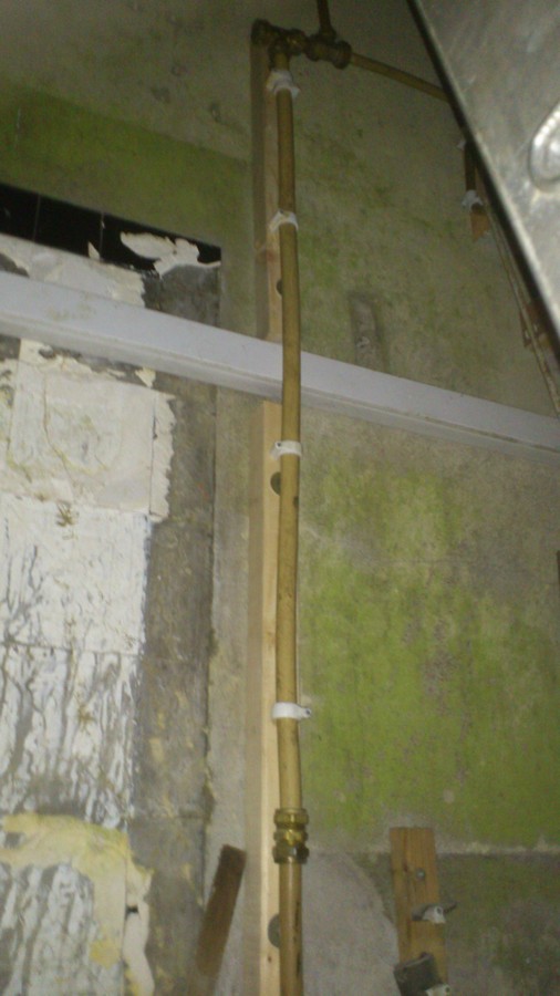

The main water collection point, downhill from the cooler. It's only 3/4" pipe, but 6ft of that holds half a litre. It will do for now, until I see how much water I collect. Easy enough to add more or a bigger pipe.

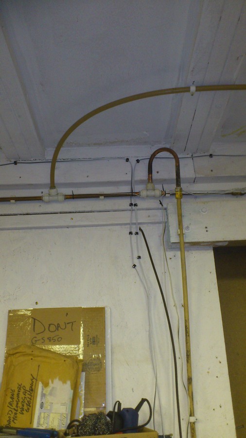

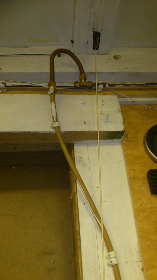

The main distribution pipe. I'll eventually complete a ring around the workshop, but for now it's just a length and a cross-over pipe to the tyre bay.

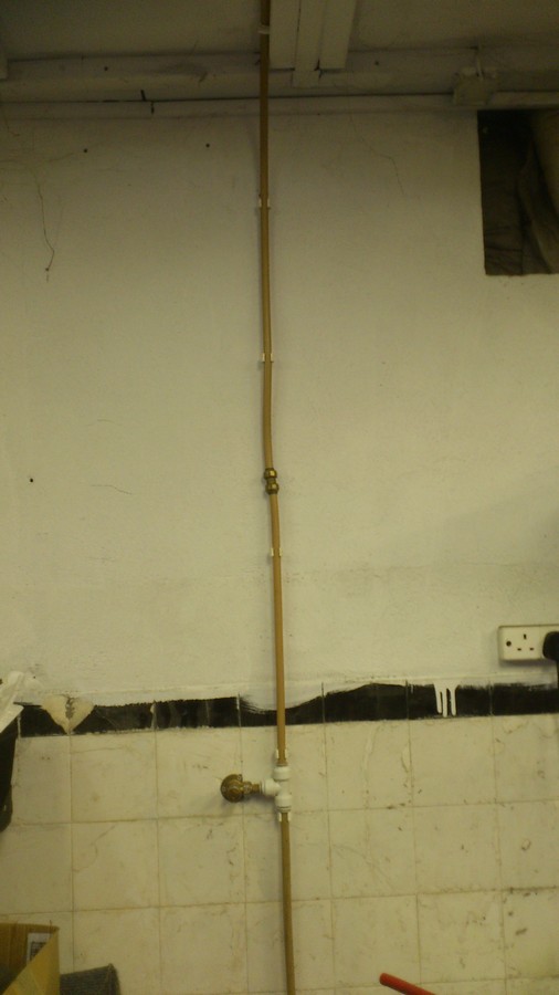

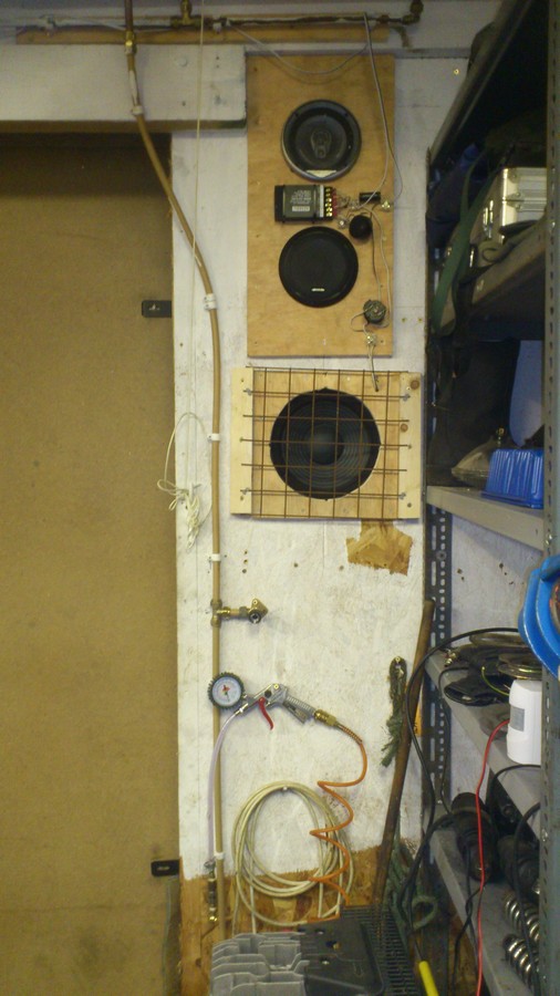

The drops by the door....

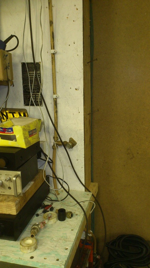

... and the tyre bay.
I'm pleased to find the rattle gun whizzes along nicely, when plugged in, with no apparent loss of oomph.
More to do yet, but that's a start.
