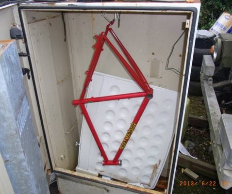

I painted the back half of a bike frame this afternoon and wondered about baking the paint. I just so happen to have one of the electrical cabinets from my mill standing outside, and I remember stashing an oil filled heater away in 1986, be a use for it one day. Made a fine oven and according to a thermocouple
it was around 60ºC in the top of the box.
I had no idea of times and temps, so I gave it an hour! I have just looked up a 2k clear sheet and it said 15mins at 60ºC.
