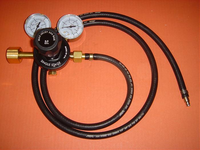

I am doing a lot of welding with my migmate 130 and its costing me a fortune in disposable bottles.
What do i need to convert it to a bigger refillable bottle
Something like this...
The small white plastic pipe on the back of your machine connects to the chrome fitting on the large bore, black hose, and the industrial regulator fits on to your refillable cylinder. The regulator illustrated by the way is for CO2 cylinders; a female fitting regulator is required for argonmix gas cylinders.

Even on thick stuff?
Absoloutely! There seems to be some confusion on the forum that CO2 gives better penetration than Argon; only when mixed with argon! The thicker the section the more CO2 content is added, but only to a maximum of 25% within pure argon. When welding very thick sections helium is added to aid penetration. Please don't get me wrong, as I am no gases expert, but straight CO2 is the S*** left over when the atmosphere has been distilled, and it is the mixed gases that provide the very best performance.

I picked up on ebay an adapter for CO/2 tank that allows use of an argon regulator.Weldequip do you do an adapter that will let me try out the CO2 from my local supplier using one of my existing argon / CO2 regulators? Dont realy want to buy a full reg only to find out I dont like using that cheaper gas.

Co2 does give greater penetration than an Argon/co2 mix. But it's less stable, creates more spatter and can't be used for spray transfer. So there.
Most CO2 is derived as a byproduct in ammonia and hydrogen plants, where methane is converted to CO2. You don't get much from air distillation.but straight CO2 is the S*** left over when the atmosphere has been distilled

Could you give me a quote for the CO2 regulator plus pipe & chrome fitting shown in your photo please?
