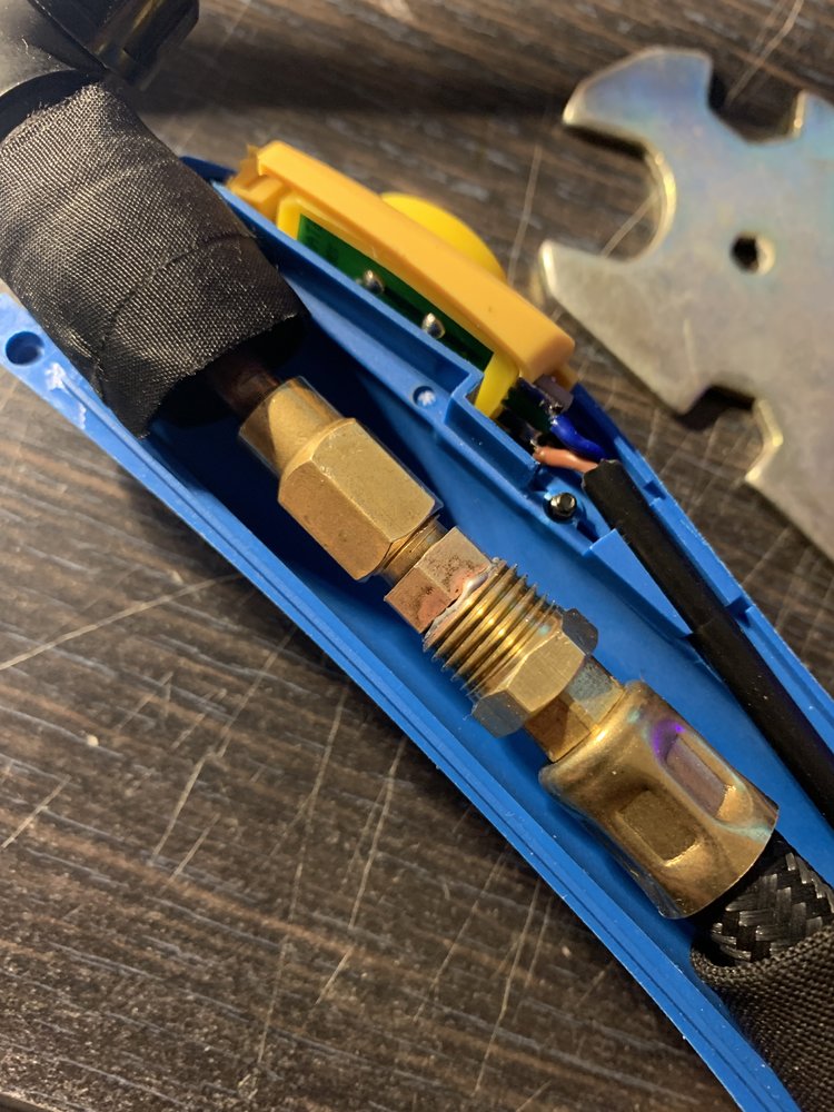

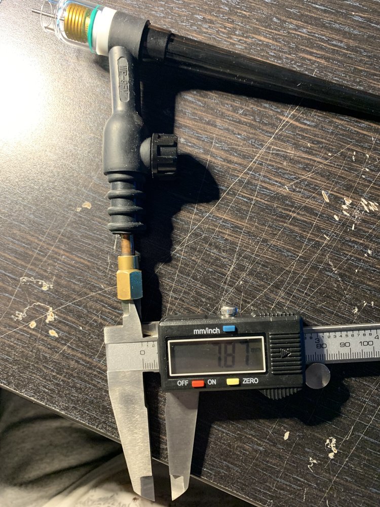

Hello, everyone, it's great to be here, I m a beginner with TIG and anything related to welding.

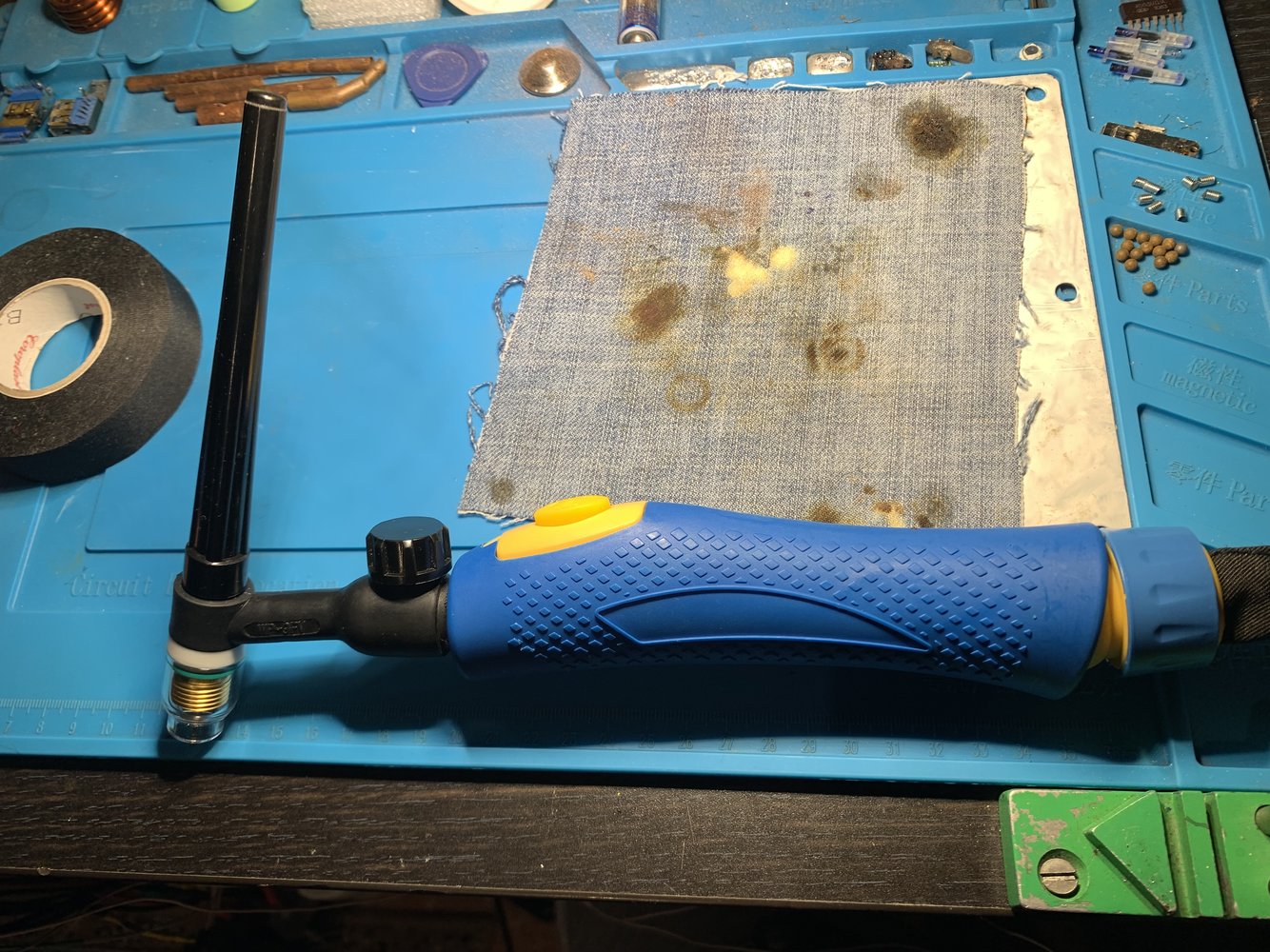

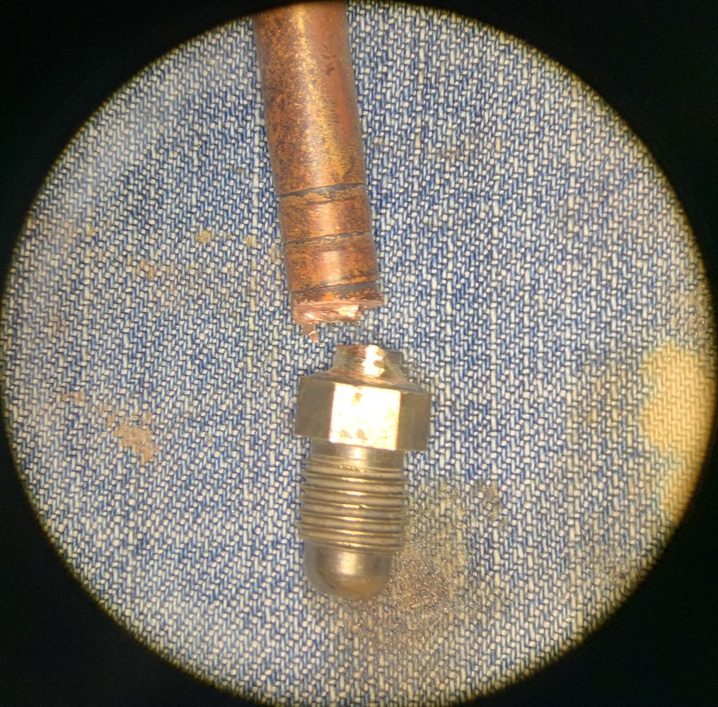

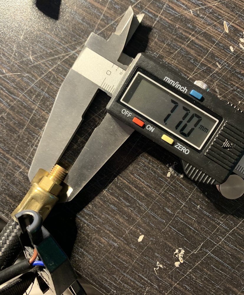

I bought a Chinese welder ws-250 TIG + ARC welding (2 in 1) for my hobby, it comes with a torch named QQ150, later I decided to buy more advanced TIG head which of course is WP-9FV Flexible with Valve, I bought all accessories for it, but to my surprise when I try to change the heads, they have different connections, my only sources of supply is Aliexpress and Ebay, this is my 3rd attempt to find an adapter but to no avail. Have ordered recently wp-9 repair connector but I will have to disturb the hose which is not desireable, I m just looking for a simple cheap adapter so I can swap the heads at my will.
The parameters that I found are as such.
QQ150 = M8x1 ???
Wp-9 = 3/8-24 UNF
I think to find the nut m8x1 and solder to the 3/8 adapter that I ordered, but I can't find, maybe I search wrong, or maybe you people have found something for sale, please let me know.
Here are the pics of QQ150 hose and WP-9 connections.
Thanks for the help and this place of discussion!
P.s. I found this on Ali but not sure if it's what I need.
