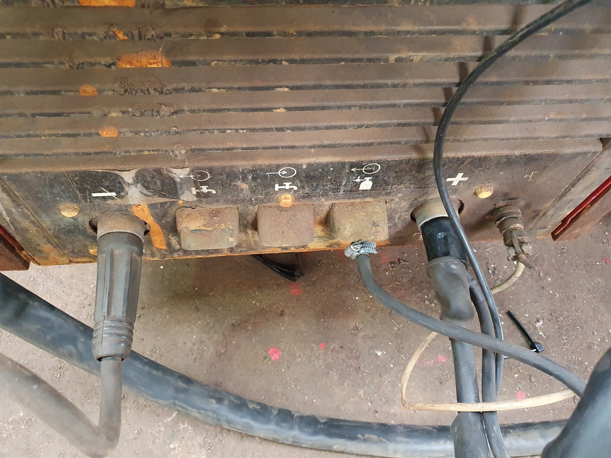

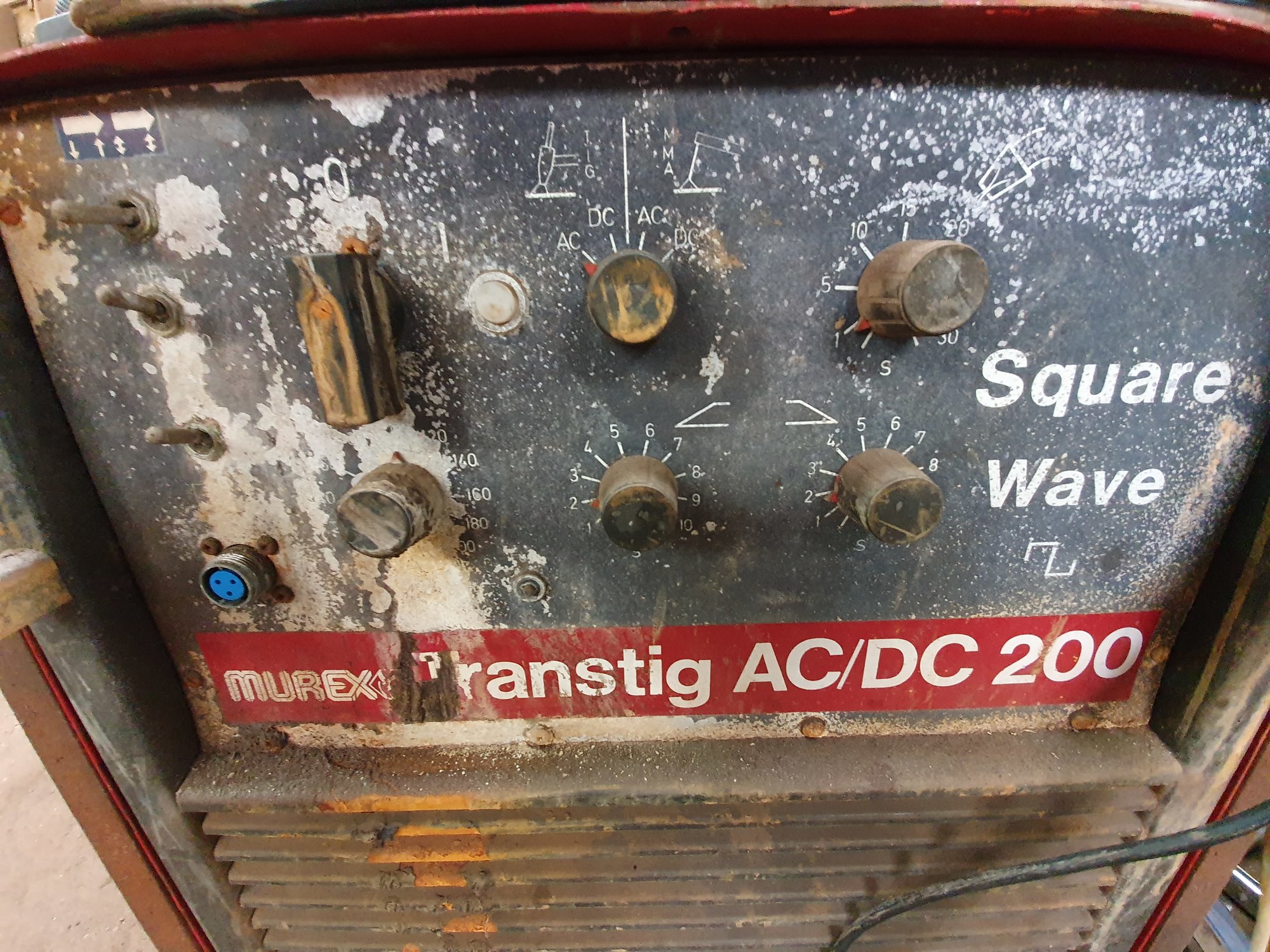

Sean64 Member Messages 194 Location Scotland ,Auldearn Aug 25, 2020 #1 Using a Murex transtig ac/do 200 squarewave. Just converted it from footpeddle to hand button . It welds fine on steel but aluminium is crap . Heres the setup 20200825_091847.jpg 522.8 KB · Views: 84 20200825_091936.jpg 625.8 KB · Views: 113
Hood I am obsessed. Messages 17,754 Location Carnoustie, Scotland Aug 25, 2020 #2 Torch should be negative, looks like yours may be in the +ve.
