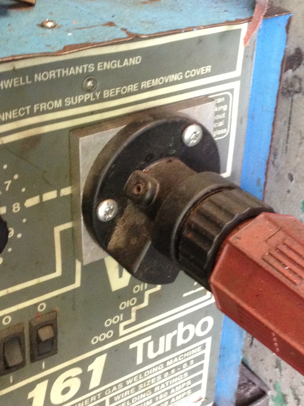

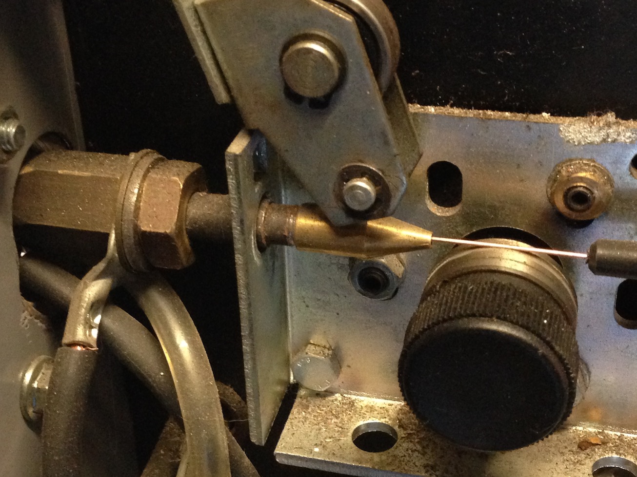

P Phil_D Member Messages 443 Location Somerset Aug 16, 2017 #1 Ive an old oxford 161 mig that has a hobby style torch and I don't like the trigger much. The welder already has a gas solenoid. Do I just need a Euro torch and socket? Is there a go-to brand for these?
S steve_s Member Messages 437 Location UK Derby Aug 17, 2017 #2 I did mine easy to do. Yep torch and socket I had to make a spacer for the front ill take a pic later
HughF Member Messages 6,407 Location Work: Dorchester, Workshop: Corfe Castle, Wife's place: Frome Aug 17, 2017 #3 Phil, I use the 'parker' brand kits off ebay for the odd conversion I do, they are decent quality and fit well. You should have no trouble converting the oxford to euro torch.
