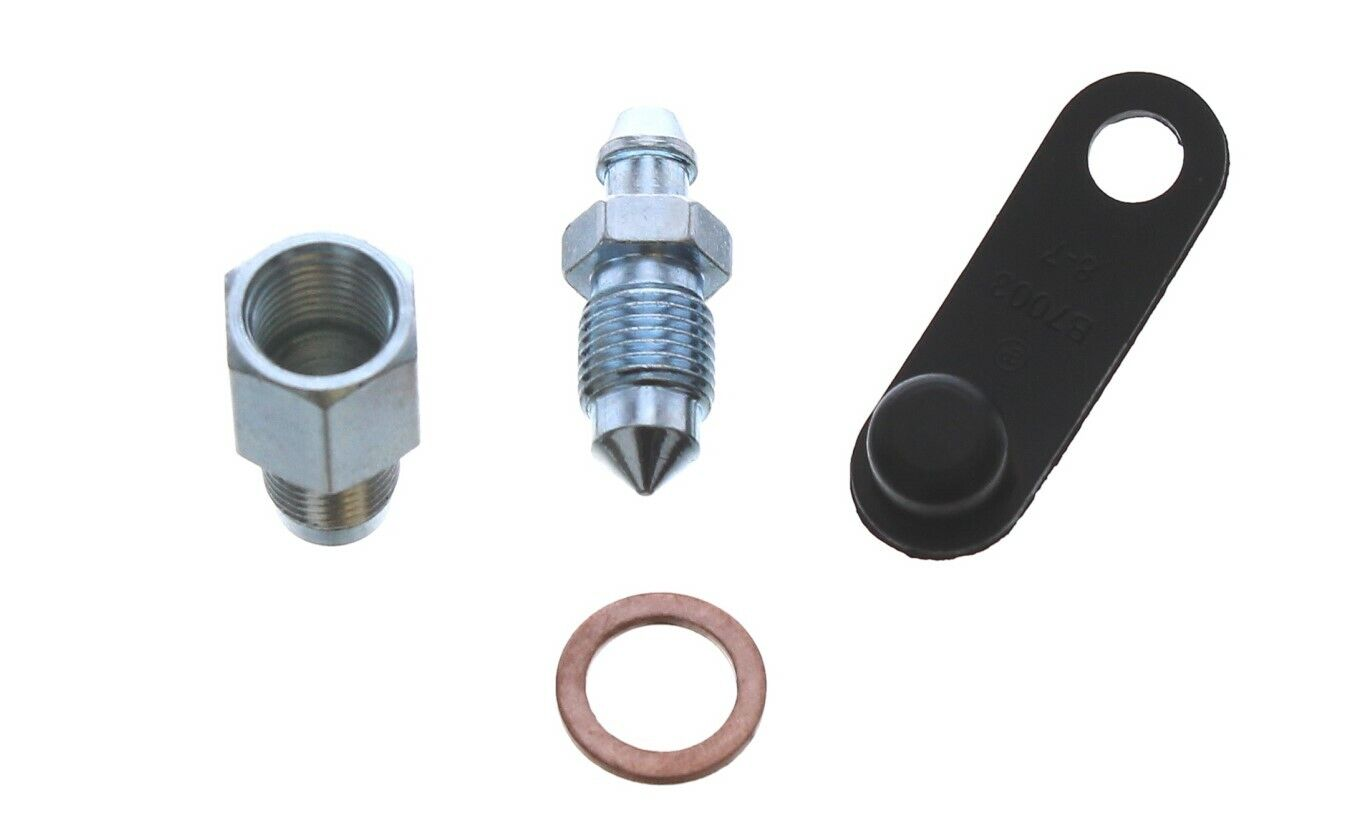

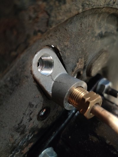

The donor wheel brake cylinder I've used on my buggy build has two M10x1.0 SAE inverted flare ports designed to connect to brake pipe. I need to change the top one to a bleed nipple. Bleed ports have a concave flare whereas brake line ports have a convex flare.
What are your ideas for a simple solution?
I found this repair kit which could potentially be adapted, though I'm not certain my machining skills are up to converting the adaptor.
