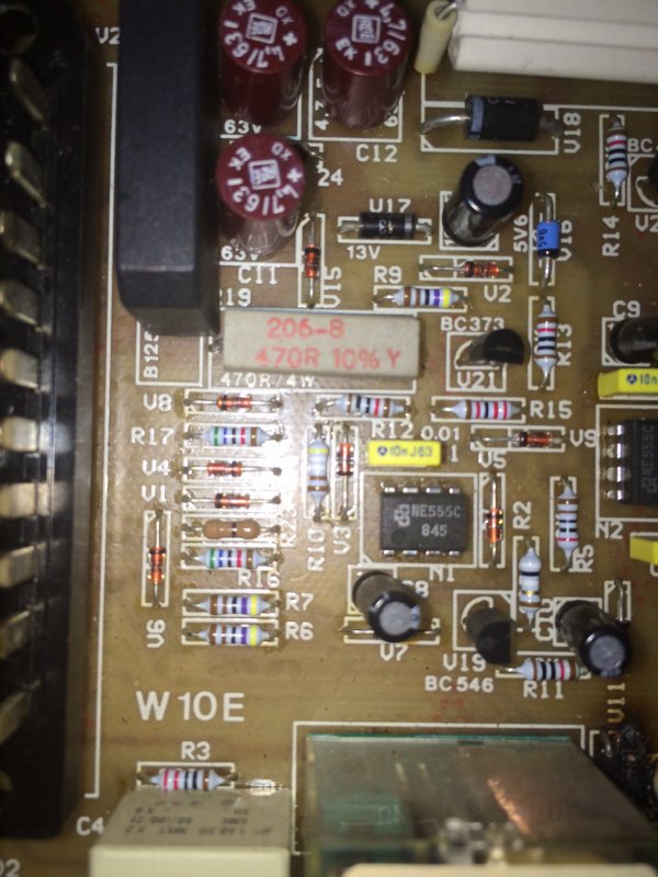

I have a contiweld 140 with a burned resistance.
This resistor has a value of 8.8 ohms but I do not know if this is the correct value because it is completely burned , as shown in the picture.
The board code is W10E maybe someone has a drawing of this PCB so I can determine the resistance value.
