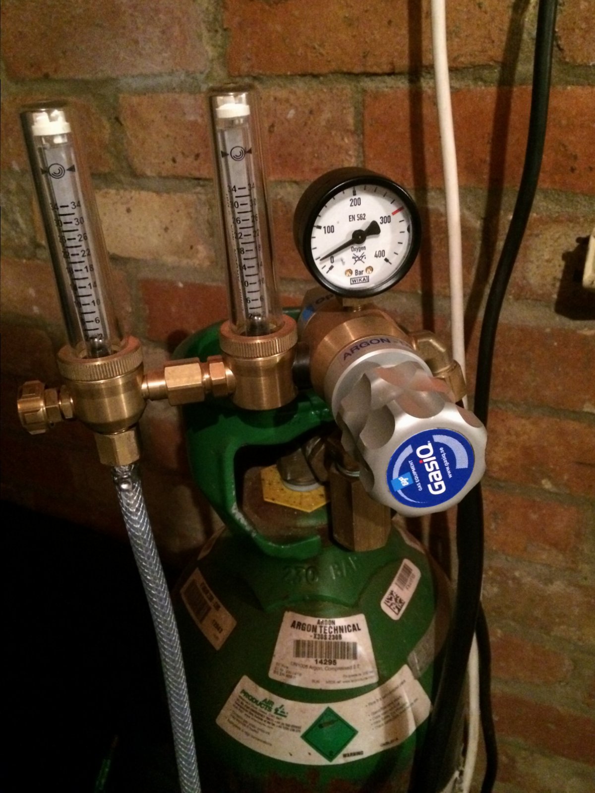

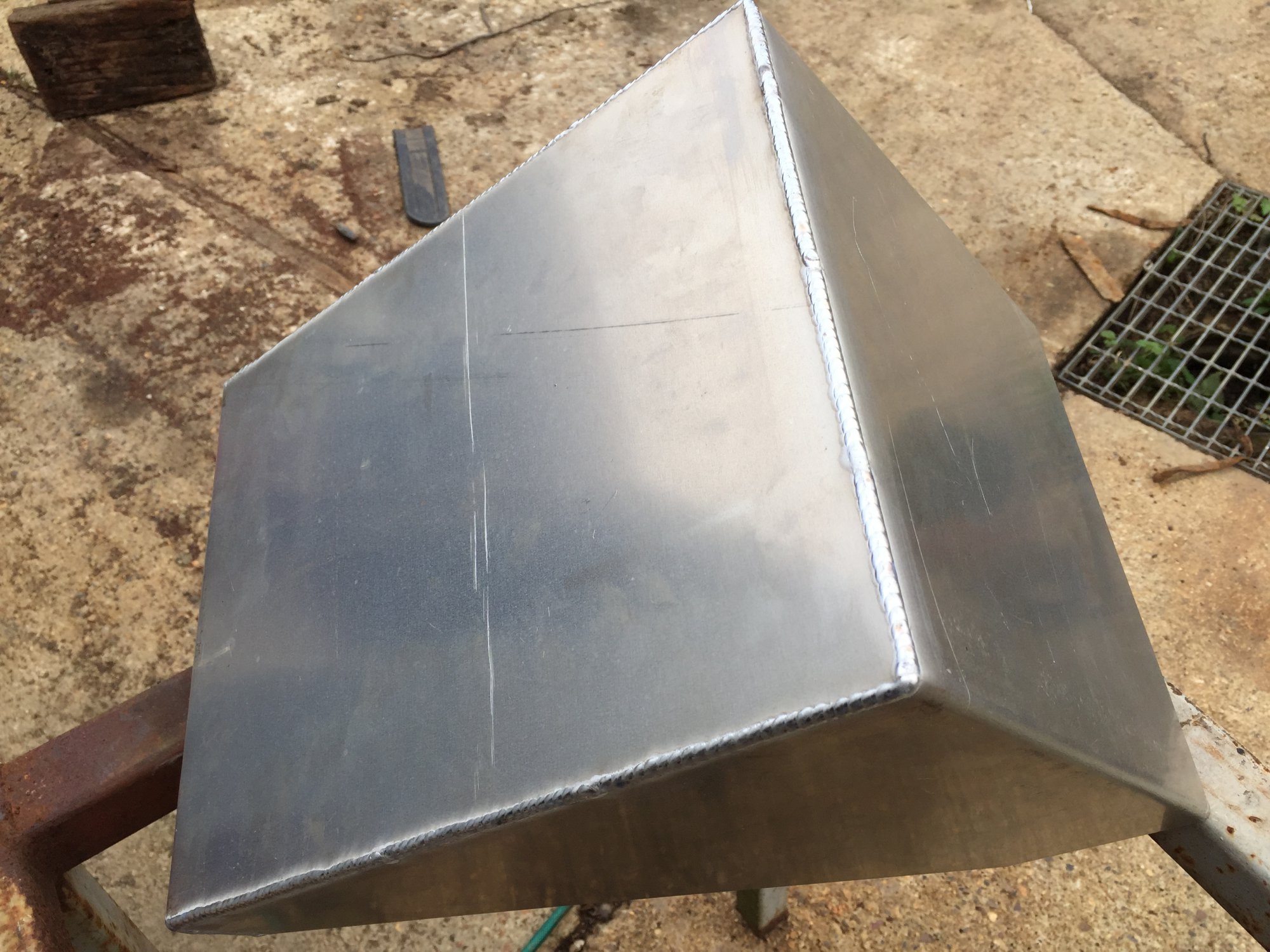

Have cleaned part (dry stored aluminium) and filler rods with acetone.
Have used a carbide burr on all edges to take off the oxidation/slight marring from the guillotine.
Haven't used a wire brushed or scotchbrite as want this to look good cosmetically.
AC balance I have changed between 30-40% EP with no real improvement.
Frequency 100Hz-120Hz
Argon 7lpm #7 stubby gas lens.
I'm starting to suspect an air leak somewhere between the gas solenoid and the torch. Reg on bottle holds pressure for days.
The only thing is it is happening with both a Lorch torch and a ck torch.
Not sure what else to try. Never had such a persistent issue with contamination. Will get more pics tomorrow.
The only other thing I can think is my wire and base metal aren't compatible? 5152 Base 5356 Filler. Too much magnesium?
I'm going to cut some 1050 tomorrow to see if I have issues with that using 4043. Only problem is that material got left outside although undercover and now has some water marking/thicker oxide layer.
