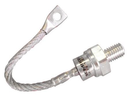

sorry to seem ignorant, down to no experience, can you tell me which is the rectifier?No spark /arc = too low welding voltage.
Test the diodes on the rectifier with a DVM set to diode test mode.
Each should read above 0.5 one way and 0 / 'OC' the other.
You may well find one or more of the diodes have died.
