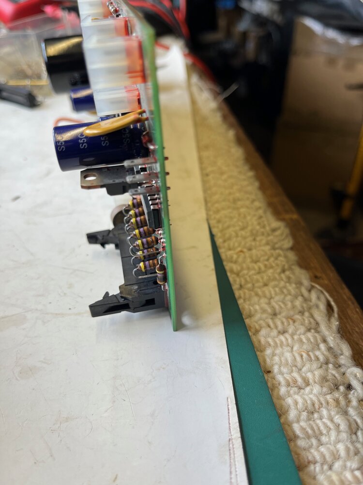

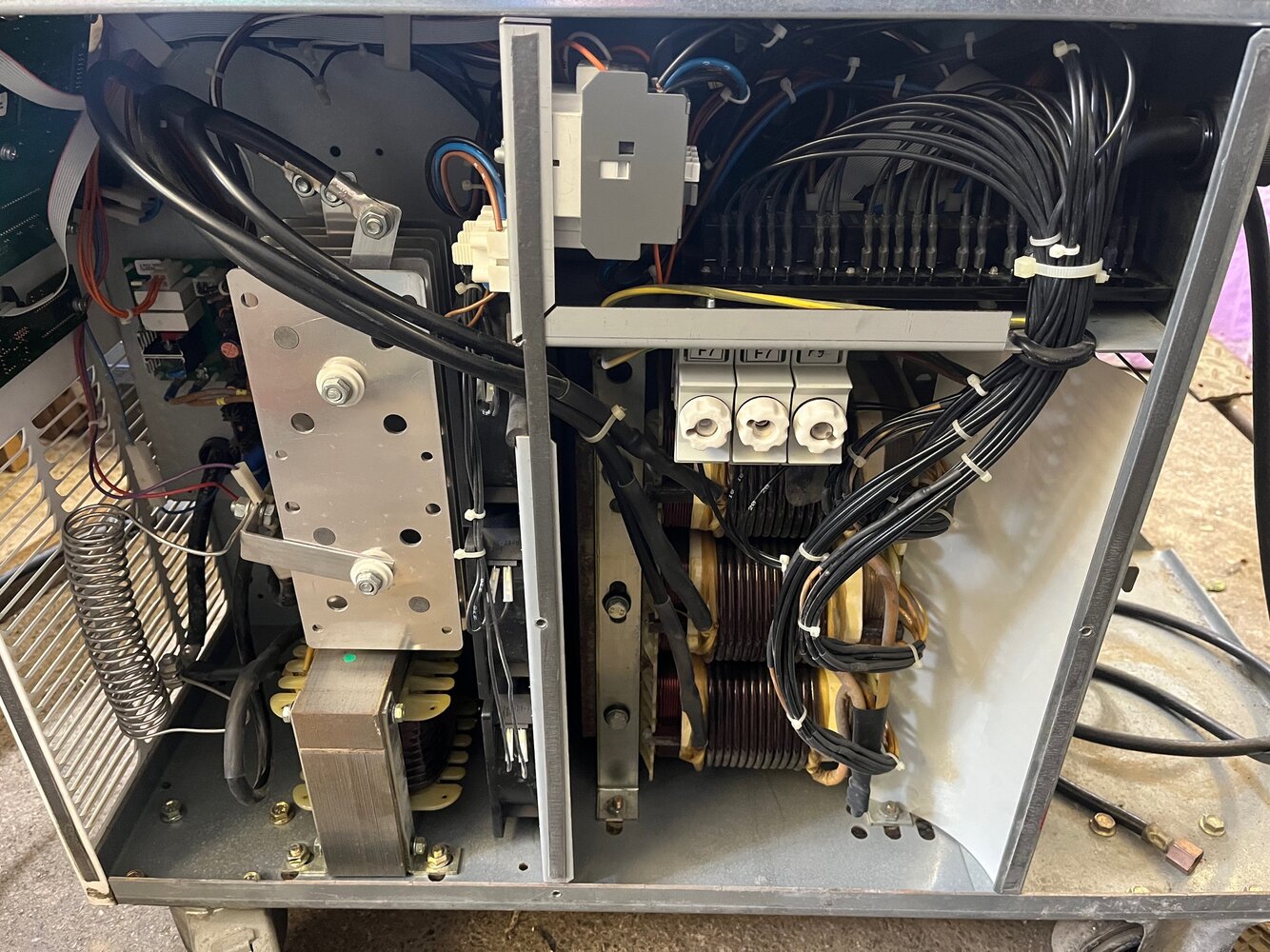

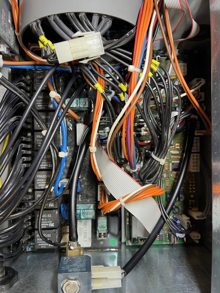

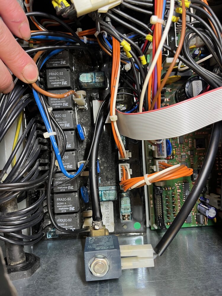

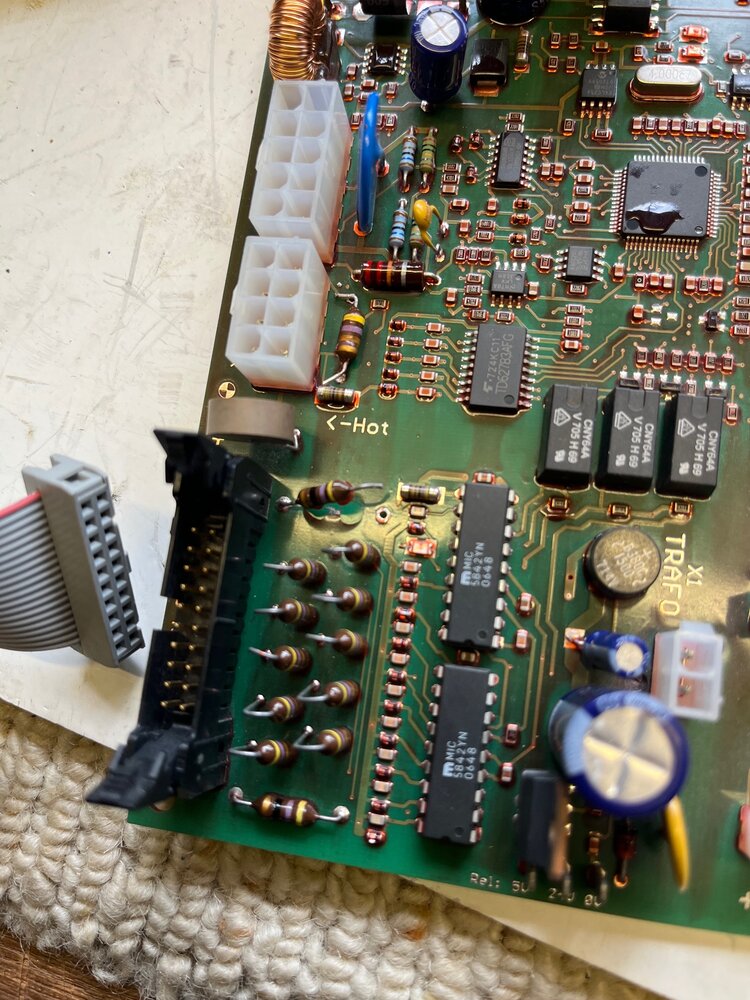

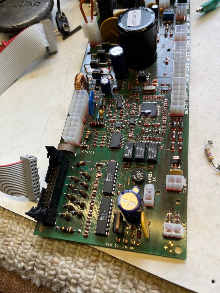

Hi, my Elektron Multimig 300 has developed a fault.
I was welding over the weekend, nothing out of the ordinary happening in fact the welder was extremely happy. I switch off and returned a short while later, start welding again and all still good, finish first weld and release the trigger and nothing, but the wire is live, the machine says '' main contactor error ‘’ so I dismantle the contactor ( which is fine and very clean, coil good ) and refit, still the same problem, one weld then an error code appears, I have tried a new torch, I have visibly checked all the boards and tested mosfets and capacitors everything seems ok.
I feel this is perhaps something obvious but I can’t see it, I presume the contactor coil is not being told to release as there is still 46v and the contactor is operating, this information is coming from the non potted board I think.
Ever come across this type of fault?, Is there anything else I can check it would be most appreciated, if I can’t get this going again I fear I will have to scrap it as the value is past professional repair ( and my workshop is very small to keep cool stuff that doesn’t work )
Cheers, Sean.
