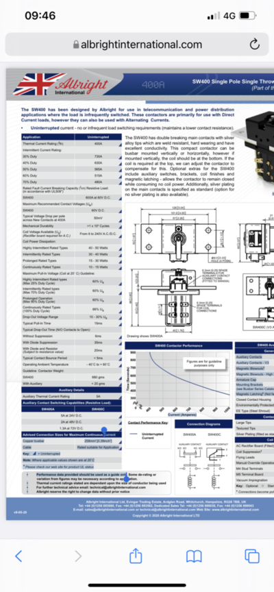

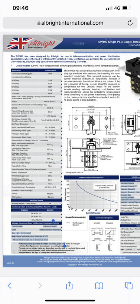

Can anyone discern what the current draw of this contactor would be?
The one i've got is 12v on the side of the coil, but i believe the original power supply was supplying about 15v.
The problem i've got is i've put a new 12v power supply on and when the contactor is activated, it causes the power supply to drop out, then the contactor disconnects. So either my power supply is not supplying enough voltage or more likely the coil is drawing more power than the switching power supply can provide.
