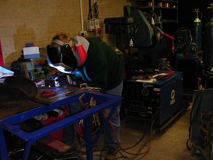

) Dialarc 250HF on ebay, didn't set me back much and it came with foot pedal and water cooler. Like Astro_al says, it does need a hefty input current though which is why as yet I haven't used it. The specs state 103A at full current!
The main to my house is only 150A.
