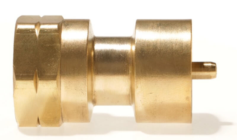

M Miller13 New Member Messages 15 Mar 7, 2019 #1 I'm trying to connect a standard 5/8 POL propane regulator to a disposable MAPP bottle. Can this adapter be had in the UK? So it's a CGA600 female to POL female (as per pict). Only available in the States, apparently. img_5192.jpg 28.1 KB · Views: 191

Farside Badly Welded Man Messages 6,589 Location Ireland Mar 7, 2019 #2 Miller13 said: I'm trying to connect a standard 5/8 POL propane regulator to a disposable MAPP bottle. Can this adapter be had in the UK? So it's a CGA600 female to POL female (as per pict). Only available in the States, apparently. Click to expand... That's likely American POL, then. Here's a place to get one half of the adaptor in UK POL and they might have a source for the other half https://gasproducts.co.uk/gas-regulators/cylinder-adaptors-connectors.html?p=1

M Miller13 New Member Messages 15 Mar 7, 2019 #3 You're right, just realised I was looking at the American POL (5/8 NPT, not BSP). Pity, amazon US could have shipped it over here for under £20 all in. I'll try that shop, it's not too far away from me.
