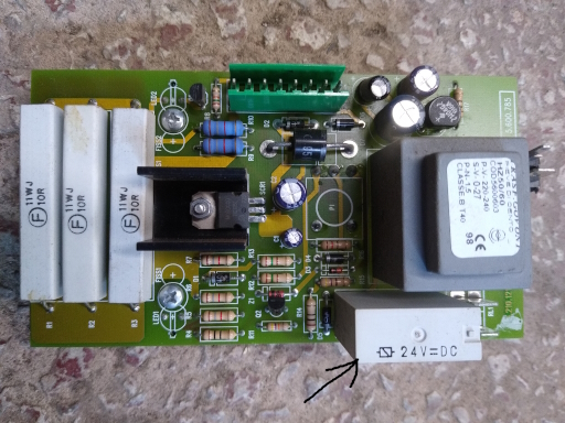

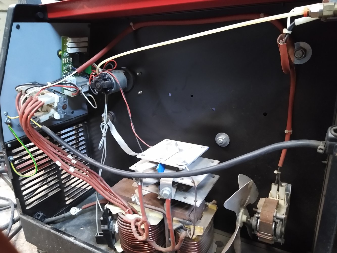

Yesterday I was using my Cebora Boxer 175 mig trying to weld nuts onto stuck locking wheel nuts for a friend. I noticed the gas was still flowing without the trigger being operated and there was also a small voltage at the wire all the time but the wire feed wasn't running, other than that the welder worked fine. Today I stripped down the welder for a look and everything is working normally again.

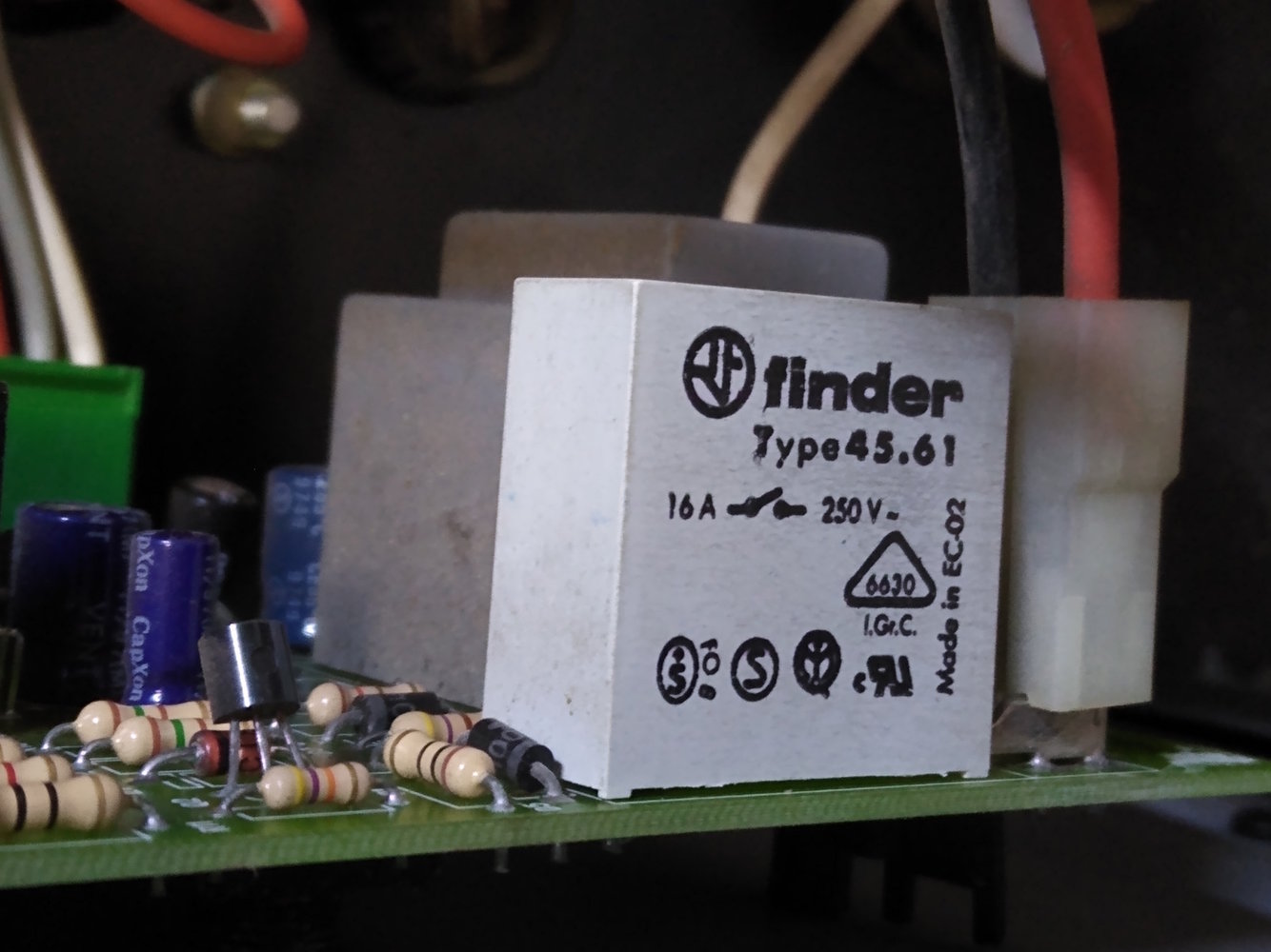

I am sure I have read on here about this being caused by a sticking relay which may possibly be cleaned?
If this is the case I will try to remove the relay cover on the PCB and cleaning the contacts. I would like confirmation about this before I mess it up completely, and would a sticking relay also send power to the wire?
I have added a picture of the board with what I guess must be the relay.
Many thanks.
