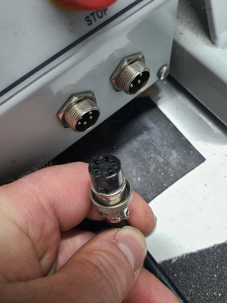

C Cheesie Member Messages 1,258 Location Lisburn Jun 14, 2024 #1 What's this connection called, knowing what to search for makes a big difference
Onoff In the land of the unfinished project I am King! Messages 13,232 Location Sevenoaks, UK Jun 14, 2024 #2 RS PRO Circular Connector, 5 Contacts, Cable Mount, Miniature Connector, Plug, Female | RS uk.rs-online.com
carbon Member Messages 3,061 Location S. Glos. U.K Jun 14, 2024 #3 Some cb radio’s had similar connections 5 pole connector you may need to check the dimensions to confirm
Onoff In the land of the unfinished project I am King! Messages 13,232 Location Sevenoaks, UK Jun 14, 2024 #4 Dims for the RS one above: 0900766b814f5202.pdf 0900766b814f5202.pdf 166.9 KB · Views: 102
iNf Member Messages 699 Location Hereford, England Jun 14, 2024 #5 Also try GX12/16/20 aviation connector, lots on ebay etc
Misterg Member Messages 1,639 Location North Wales Jun 14, 2024 #7 "Aviation" connectors as above. 12/16/20 refers to the diameter. (They look like 16 from the photo)
