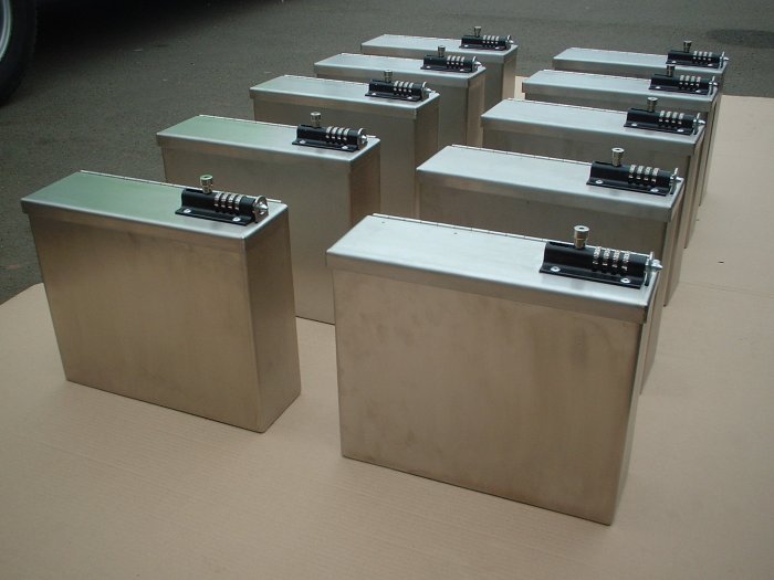

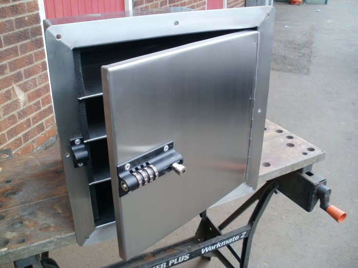

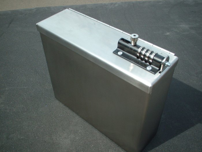

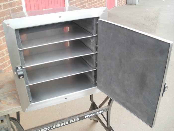

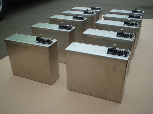

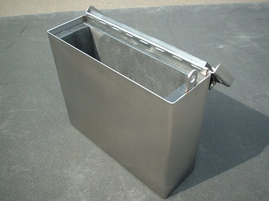

A bit more sheet metalwork.
These are stowage boxes for toughbook computers, will be fixed to the side of the drivers seat in a fire appliance.
Made from 2mm stainless steel, lined with closed cell foam, there are 4 studs welded to the back face for easy fixing, They're not designed to be top security as the vehicle is rarely unattended, just to stop the snatch & run merchants.
