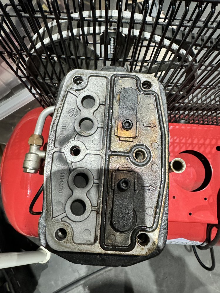

Check how long it takes from a flat receiver to when the motor trips, then load it up with the piece of wood, check the time if the motor trips with the wood pressed against the rim of the pulley, try and monitor the current the motor pulls and if you can, try and keep the current the same as if it were driving the pump…Thanks @dobbslc makes sense but definitely no leaks, replace the non return valve is one of the first things I did because I wasn't sure about it. It's working fine and the receiver will hold pressure even with the cylinder head disconnected.
@Chippie sounds good. What exactly am I looking for/how much resistance am I trying to apply with the 2x4? If we already know its fine running with no load and struggling with the pump load at 5 bar am I just looking for another reference?

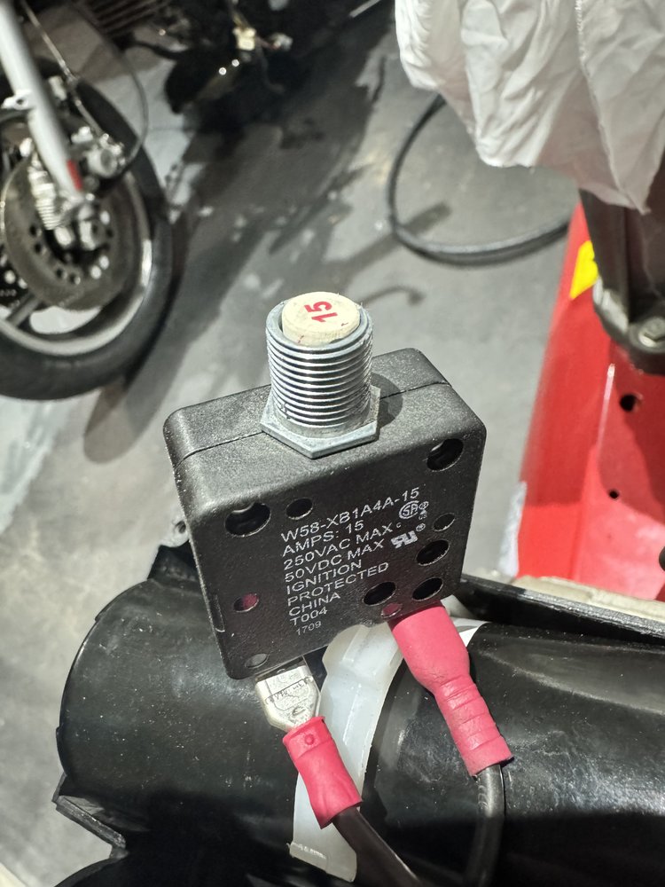

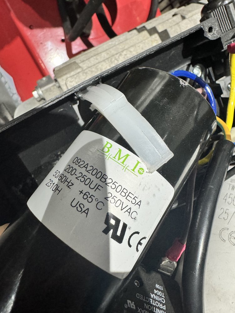

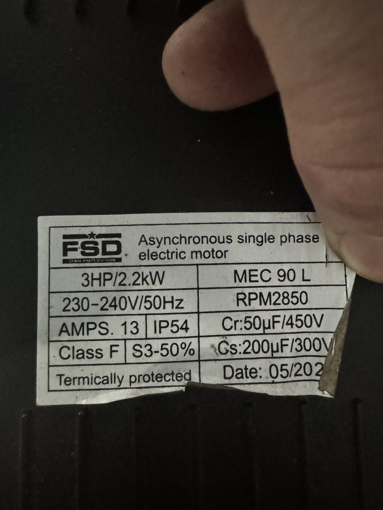

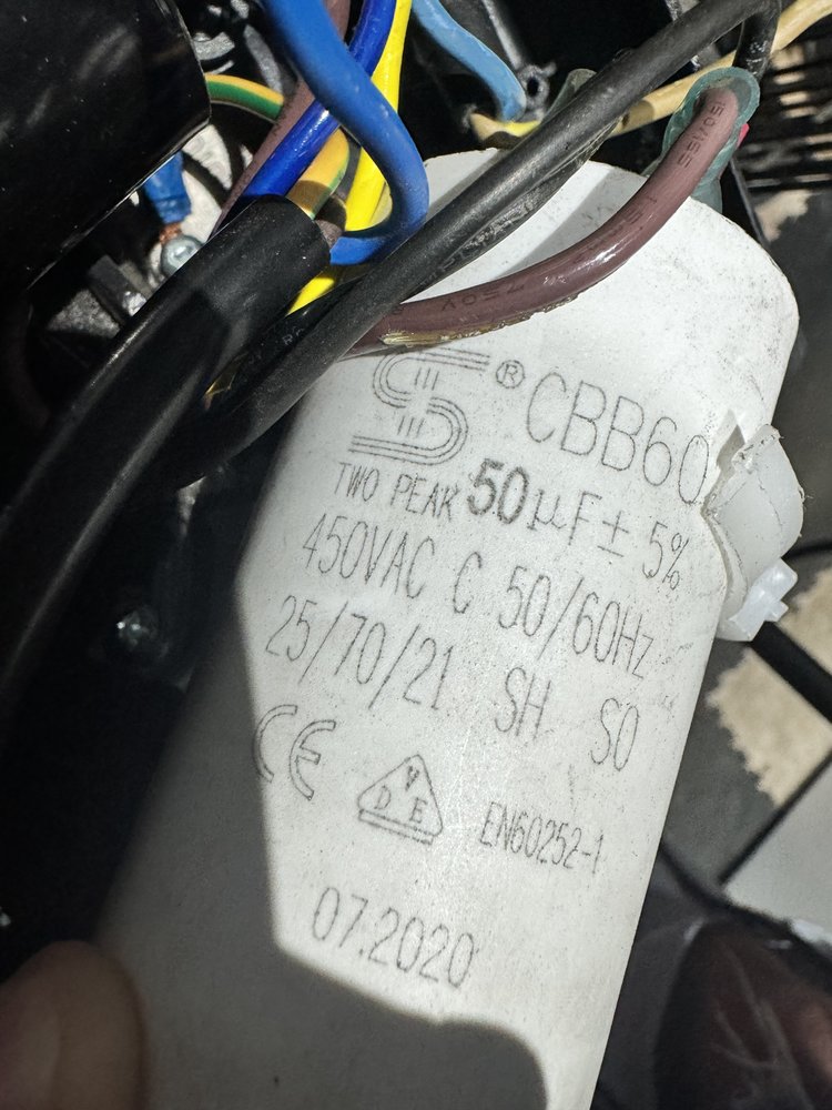

Either that or we are back to the usual reason for excess current - the motor. BTW searching the motor code MEC 90L throws up a SIP compressor motor.In the first post you give 238v at the plug. Have you checked the voltage with it running all assembled correctly. Are you using an extension lead with this? If the voltage is low the motor speed may be dropping and the start cap might be switching back in causing the current to increase above the 15amp rated trip.
