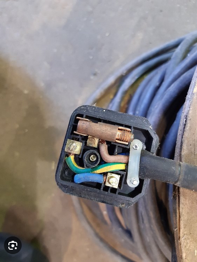

Is that a special 13A plug with no fuse?my comps and welder run on a Chinese 13 amp plug and have done for the last 50 years![]()

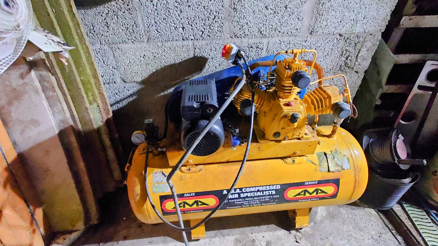

If that compressor is like mine, it's not fitted with any protection. I would rather fit something smaller than a 40A RCD. Maybe wait for an electrician to comment?Having suffered a major fire in one of my launderettes some years ago I know what detail insurers go into after the event. So there is no way I'd install a bodge like that.
In the event it was shown to be the incoming head unit / company fuse but by heck was I put through the mill - they even wanted inspection certificates going back (iirc) five years (which I had).

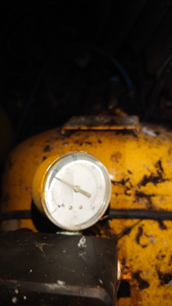

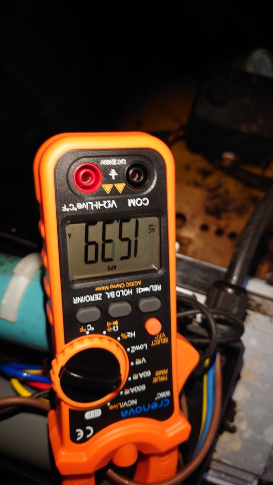

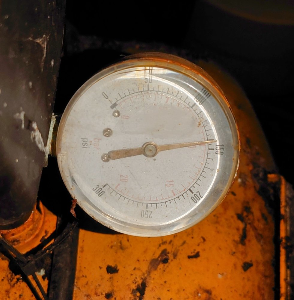

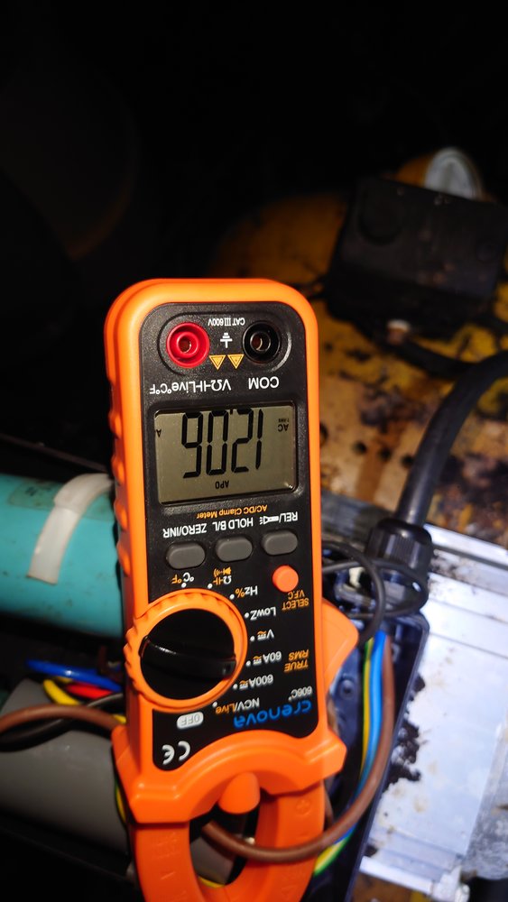

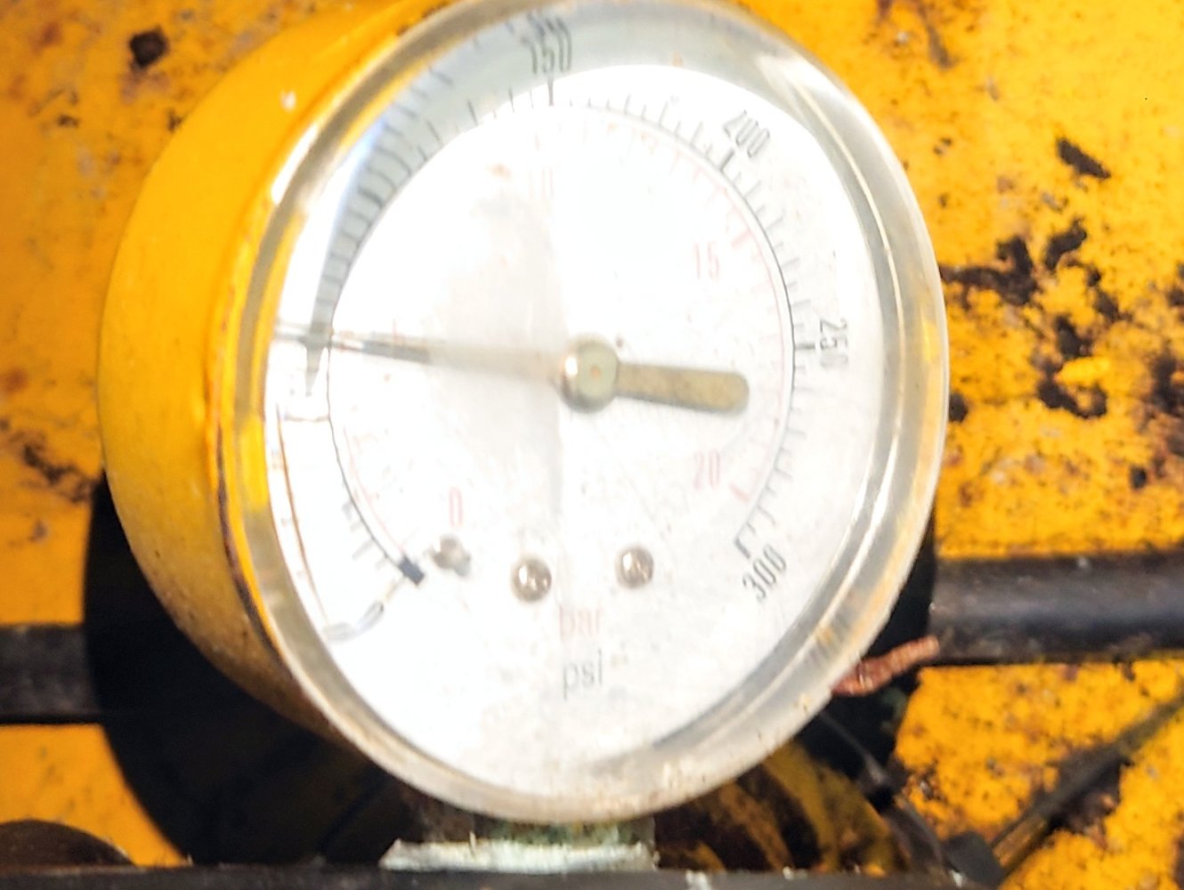

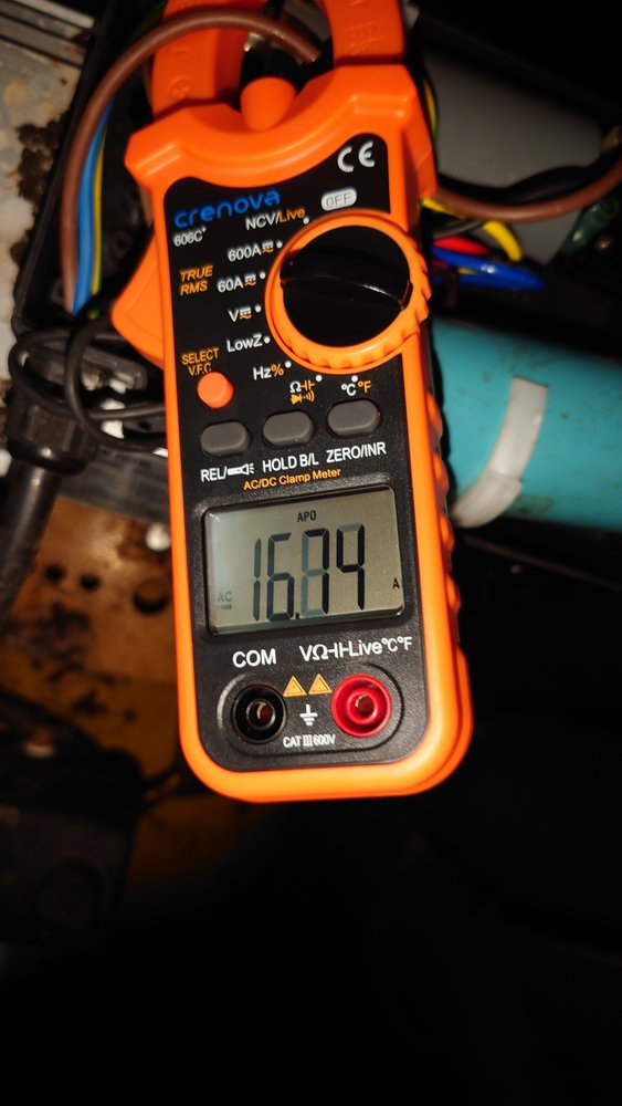

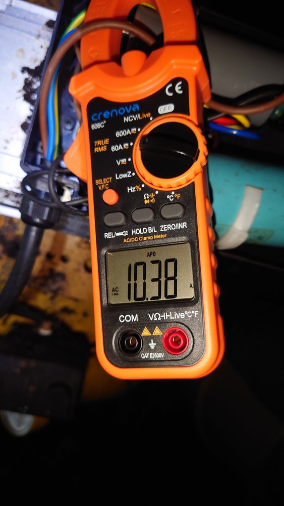

I am hoping I can squeeze in the 6 mm butyl cable run off a 62 amp commando plug / socket fed via a 40 amp rcd
Had a similar experience with the single phase Ingersoll Rand V twin compressor that I used to have. In my case the burned out motor the compressor came with looked to have been caused by someone having disconnected the 'starting off load' due to an air leak. I fitted a new 'off load' setup and a new Clarke 3HP motor. This motor slowed down as soon as there was any real load; it turned out that the motor was capacitor start, but induction run; so, totally unsuitable for my use. After some argy bargy, Machine Mart gave me my money back and I bought a Brook Crompton capacitor start capacitor run motor; problem solved.I was given a 3hp compressor because it fried the motor.
I took it apart and found it had been rewound.
I put a new 3HP motor on it (with thermal overload)
It started fine but when my back was turned, it began to labour (when getting towards full pressure) and fried the new motor. The thermal overload didn't save it.
I thought it was a mechanical issue but couldn't find anything wrong
