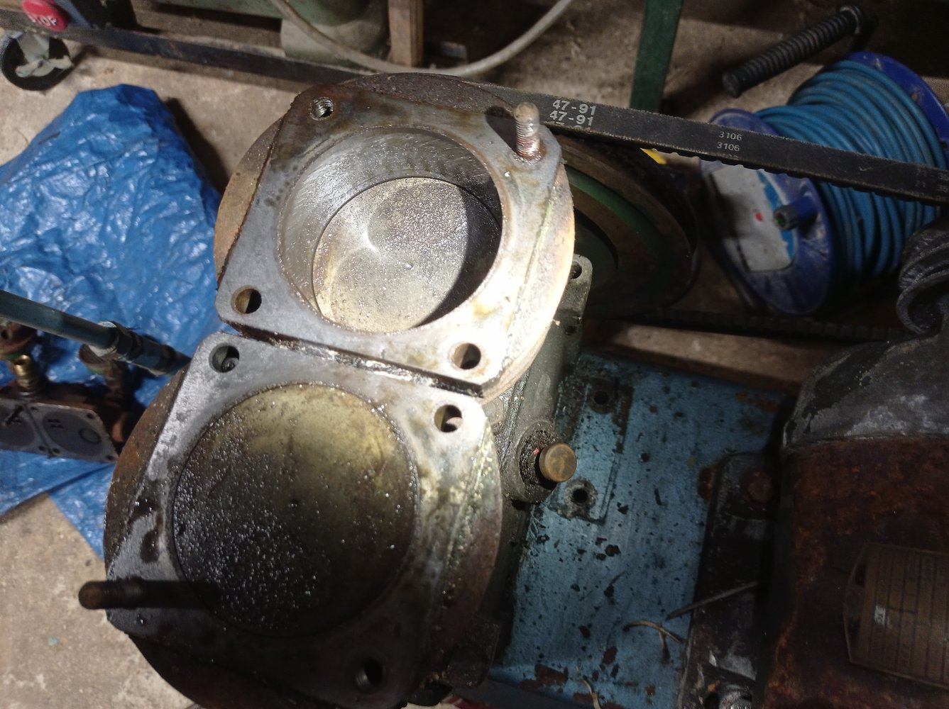

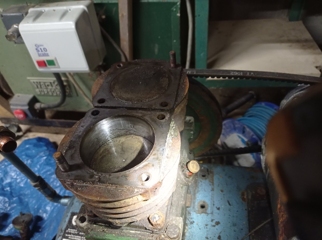

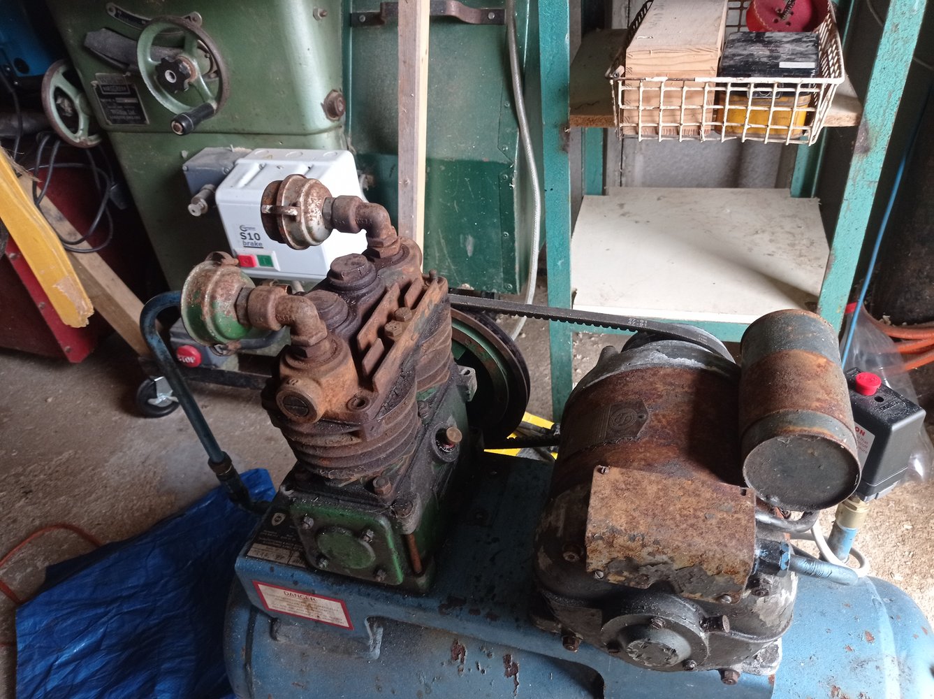

I understand the run it till it stops and whip off belt comments now thanks. That makes sense. Yes that's a ideal way of isolating electrical Vs mechanicalRun it up again until it slows right down then whip the belt off, check to see if it's the motor or the compressor that's gone tight. If they both spin freely then is probably not a mechanical problem with either so must be the motor![]()
