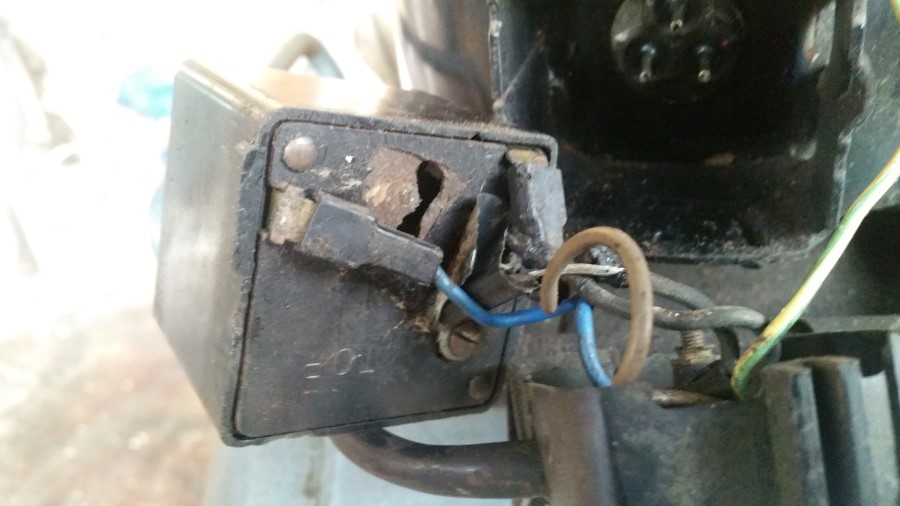

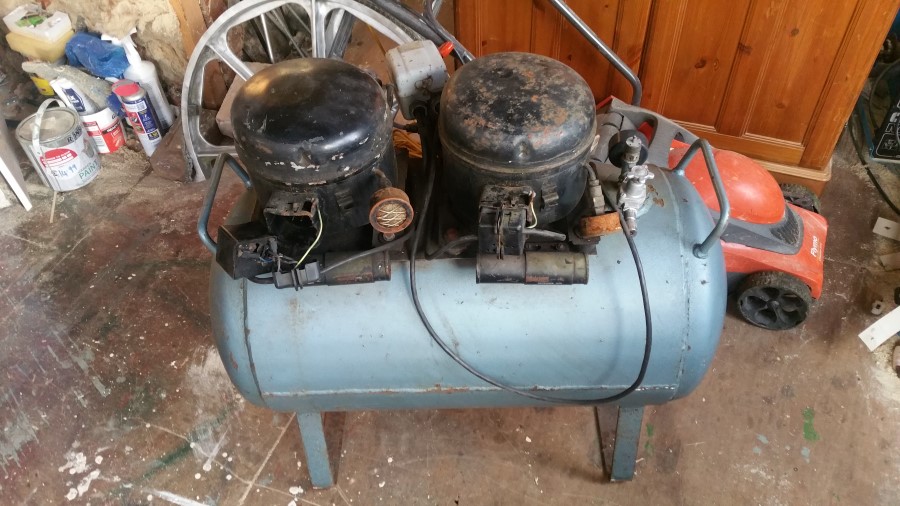

It's a Porter Lancastrian silent compressor, I have the same one. Pretty sure the broken bit is just a terminal block, the lids are long gone off my one as well. Yours is the only other one I've seen so I doubt spares are available![]()

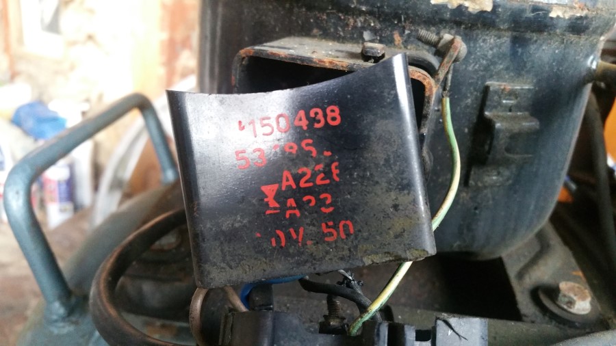

You will just have to put it back together as best you can so the live terminals are covered up.

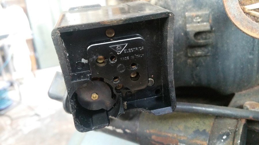

Yup definitely the start relay. It's basically a current relay that switches a start winding in When the current in the main winding drops as the motor runs up to speed the relay drops out and disconnects the start winding.
PS - ignore the wire labelled "S" the image is from a compressor project I did a few years ago
