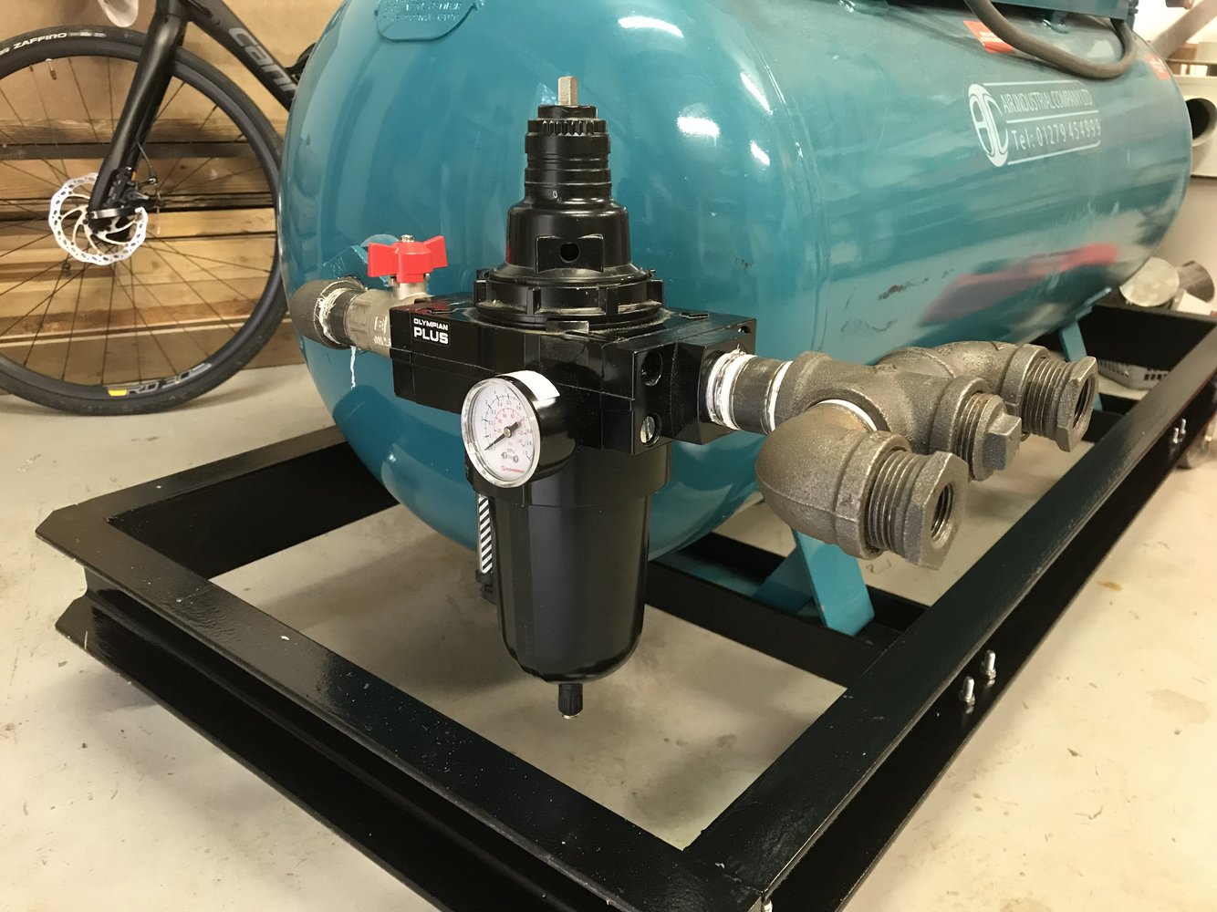

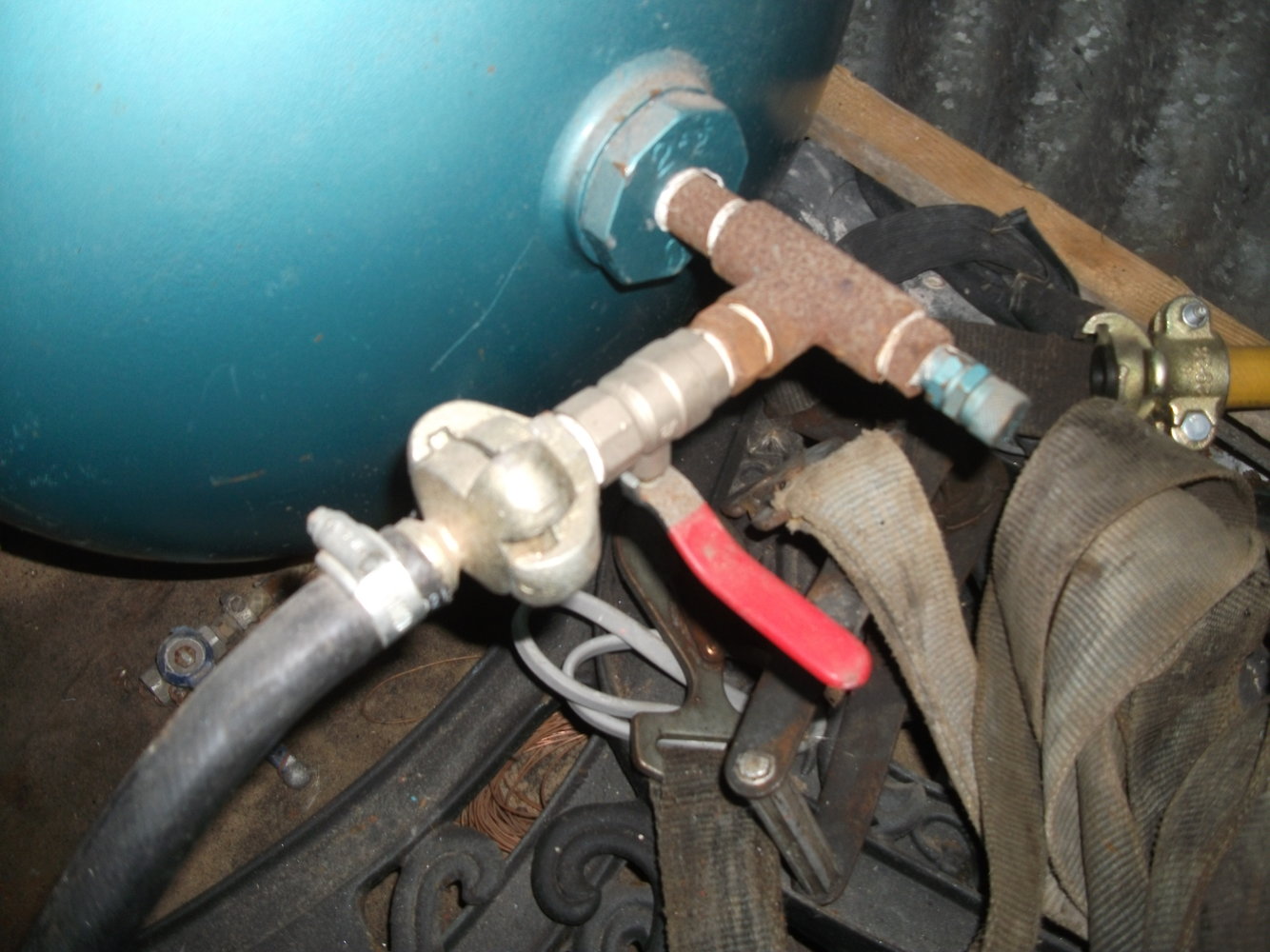

Thanks Mm,It isn’t a bad idea to have some distance between the outlet and the regulator to allow moisture to condense.
Also I personally would try and avoid mounting the regulator direct to the compressor anyway, as it vibrates a lot.
I’m struggling to see what’s wrong with what you’ve done to be honest, if it works for you leave it like thatthe only thing that might be useful as said is a connection before reg to give you full flow from tank.
Yes, me too.I connect mine "One at a time"...

very rare (so far, never) to use two or more simultaneously
takes about 3 seconds to unplug one tool and plug-in another with quick connectors...
