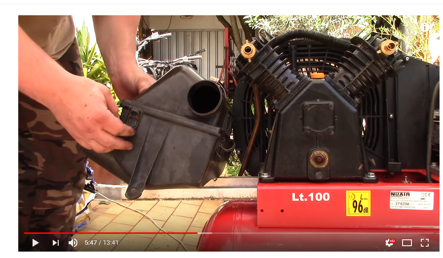

I recently picked up a new compressor without taking into consideration the noise (and subsequently ****** off neighbours) so I'm looking to modify it a bit and hoping anyone would be kind enough to point out any glaring holes in my plan?
I plan to remove the compressor and put it in a box lined with acoustic foam, with a muffled inlet and outlet and run the air outlet to the receiver via a water trap (extending the pipe distance approx 30cm from oem. I can't think of a reason I can't do this apart from possible heat issues but would like a second opinion.
Excuse my terrible drawing skills: https://imgur.com/a/gWRiQve
Cheers for taking a look
