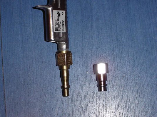

I always stick to the PCL couplings (on the left) Much easier to get hold of, and much more widely used.
The ones on the right 'Autoflo' are harder to find.
