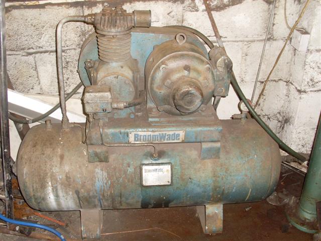

My compressor has been set to cut out @ 115psi then cut in again @ 80 psi. Lately when it,s started up it only gets to 40 or 50 psi and starts to struggle (motor slows down)and won,t go any higher , sometimes it works ok but most of the time it won,t. Today we took the head of and gave it a clean up and fitted new valves, fired it up and it got to about 80psi and that was it , drained it down and tried again , straight up to 115 no problem , cut in and out ok a couple times then wouldn,t go past 50 psi again.Anyone know whats going on here?
Just out of intrest slackened the belts off again and when it reached 50psi the motor stopped again so retightened the belts and everthing,s fine. Doesn,t make sense to me but hey it,s working ok now .
