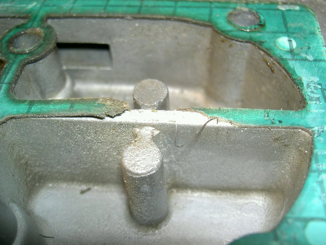

i noticed tonight my air cut off tool was cutting out constantly and when i checked the compressor it was only making 50psi and running continuously.
when i turned it off i heard a hissing coming from the air filter indicating the HG had gone. I whipped the head off it and sure enough found the picture below.
I just wondered if anything in particular is likely to have caused it to fail? basically I had a feeling yesterday evening that the compressor may have over filled as I remember thinking it was running on for quite a while and when i glanced at the gauge it looked higher then usual (cant remember the exact psi) so i knocked it off manually. I just wonder if too much pressur ein the tank could have blown the gasket?

put a new one on and watch the pressure when it builds up and cuts out make sure the safety valve works at corect pressure as well
